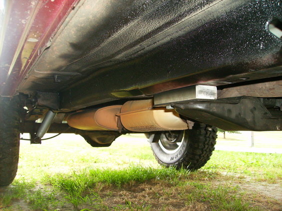

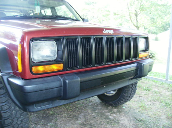

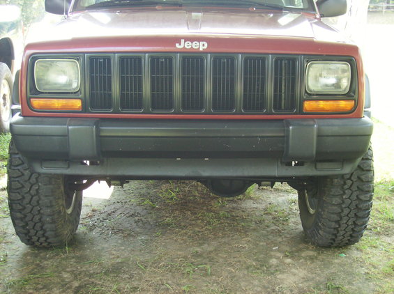

Got some updates.
Painted the grille and head light housing. And finished painting the axles and "frame".
Here's a few pics:
Found this while lifting. The factory tag with serial number and says 8.25 Jeep and 3.55 open case. Pretty neat and shows how good of shape its in.

post #29 of 264 Old 06-22-2008, 06:37 PM
lhp21
Location: United States
Posts: 47
In very good shape and looks great! Did the prev owner give you the history? Looks like it has been babied.
lhp21 is offline
post #30 of 264 Old 06-22-2008, 10:11 PM Thread Starter
broncofire75
Location: Toonnerville, GA
Posts: 2,062
I have every service record of everything from major tune ups and new brakes all around to just changing the oil.
Also, have the original window sticker and reciept from the dealership. $23,000ish out the door if I remember correctly.
It has been babied all highway miles and 4 wheel drive maybe twice before I got it for icy road driving. Even the transfer case fluid has been changed twice. And thats just out of the few reciepts I looked at.
