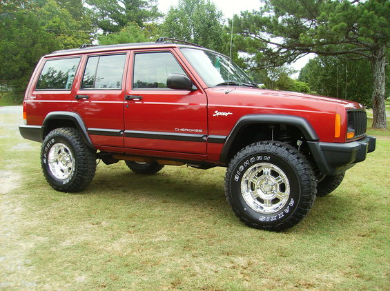

Here's a stock vs. how it is now look so you'll know that this is the same Jeep after a few pages LOL:

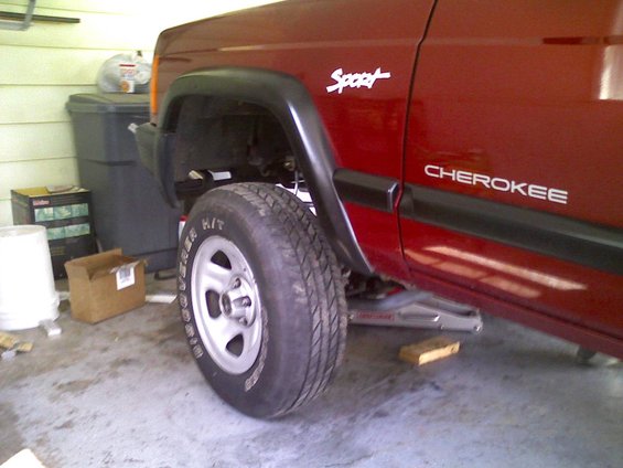

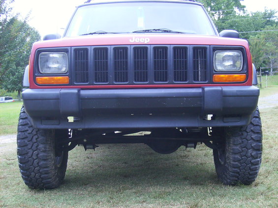

Here's after the lift done in the front:
Here's the lift and tires on(had full set of stock wheels and tires in the back):

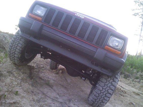

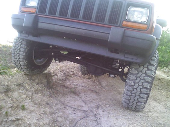

Here's a few from the flex/clearance test at work:

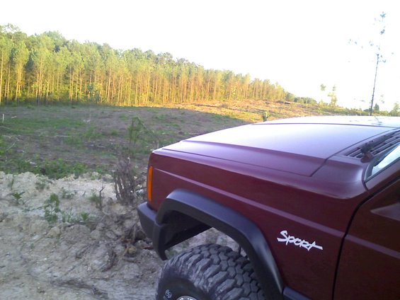

Here's from this evening at the hunting club:

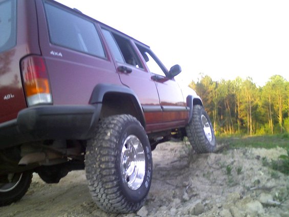

Few more random ones:

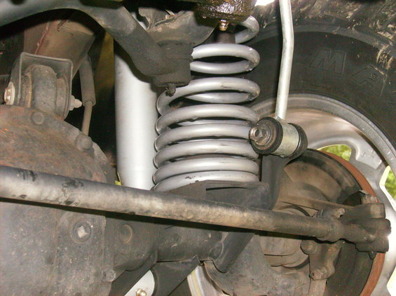

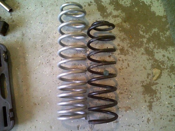

Progressive rate coils

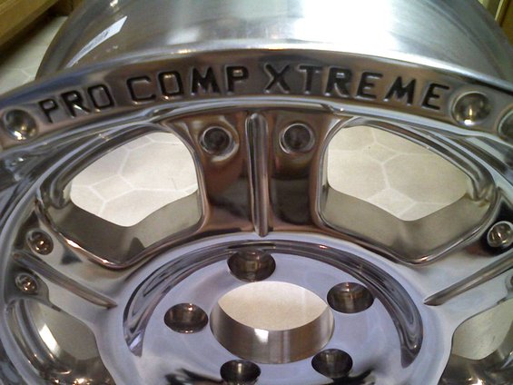

Wheels:

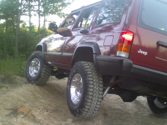

Also, I'm adding a 1/2" block in the rear next week to level it out. Then its the exhaust, intake then SYE. Trimming the front bumper a bit the tire jus touches it when flexed right. And, cut and folding the rear under the bumper end caps and cutting them to keep from what you see in the pic from happening.

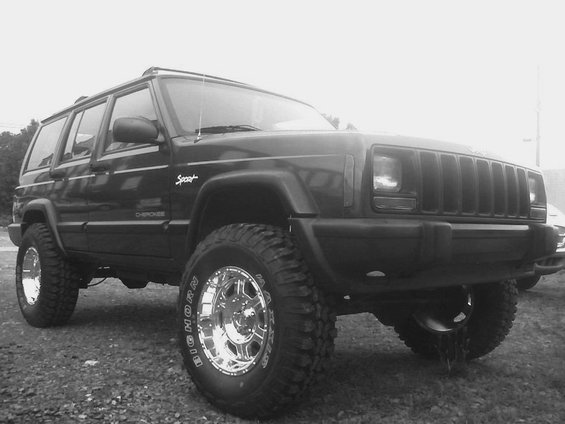

Are your swaybars connected front/rear?... they have to be....
Seems like very little flex, the rear is in the air on that 6th pic?
check mode

you can see they are connected in the pics before.

Ya sway bars on dang it. They had to be for the size tires without rear bumpstop exts. The pic is very decieving though that ledge had to be about 15-18 inches high and the right rear dug in in 2WD so its little steeper than the pic looks. But the tire is off the ground about 3 inches. I couldve went all the way up and over that with them on and easily off.
Once I do the SYE I'm probably adding an inch or 2 to the lift and ripping out the rear sway and mayb making some front disco's.

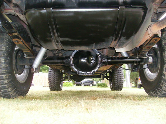

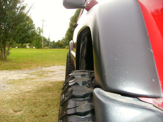

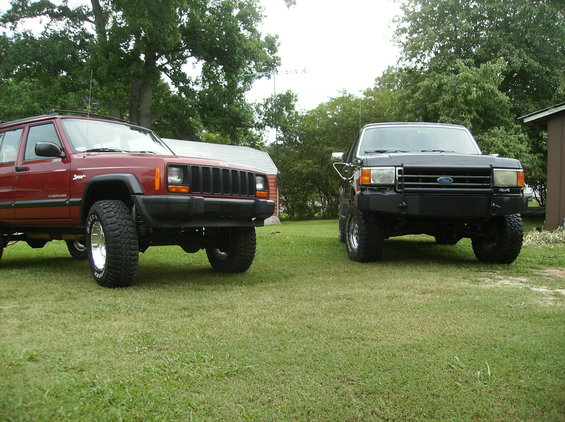

Cleaned it up tonight. Took some pics with the digital camera and washed my Bronco and snapped a few with the Jeep.
Painted the rear axle til I ran out of paint.
Better shot of the pro rate coils:
And with the Bronco 3" lift 33" MTRs custom bumper and sliders.
Cleans up real good don't it? I like how the flares and the tires are about at the same width. The new piant on the flares looks awesome and they came out alot better then I thought. Can yall tell that I haven't paint the front bumper yet? haha
