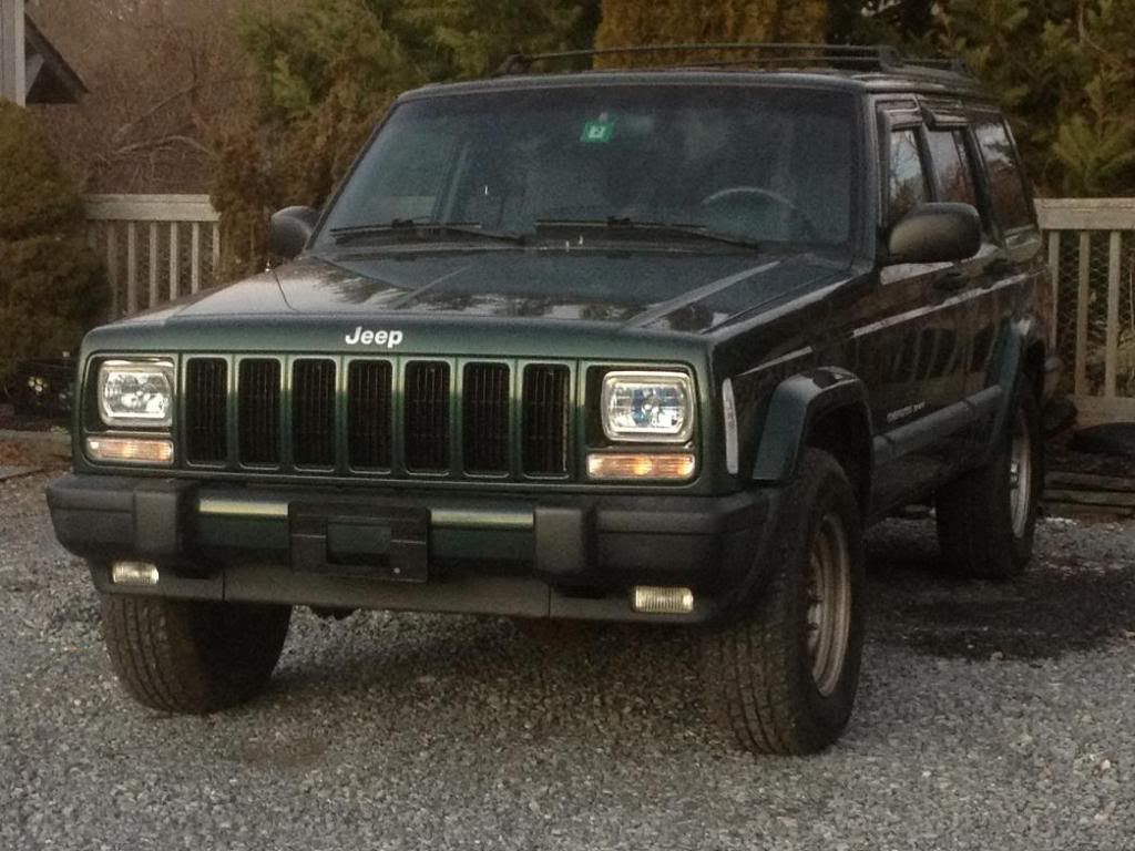

Thought id start a build thread after getting so many ideas and being inspired by alot of the builds on here
Picked up my first xj after owning a few zj's
The day i got her
Installed some clear marker/corner lights and some new headlights with halo's

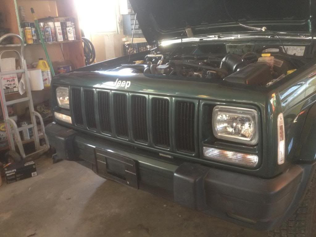

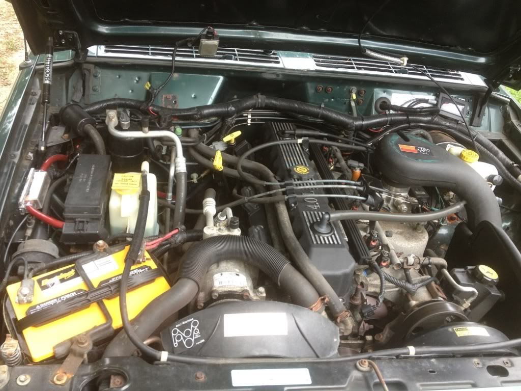

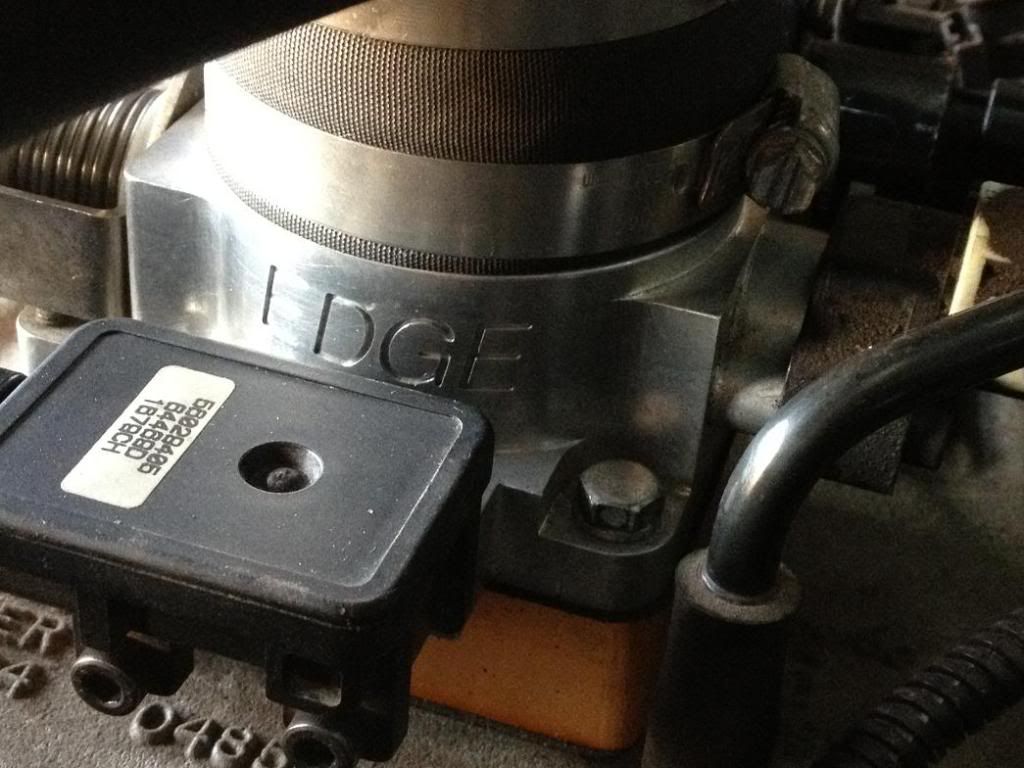

Next on my list was the valve cover and Intake
K&N Intake
4.0 Aluminum valve cover
Rustys throttle body spacer

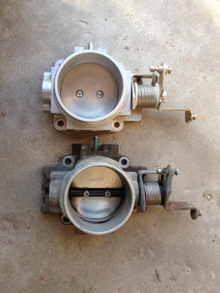

Edge Throttle body

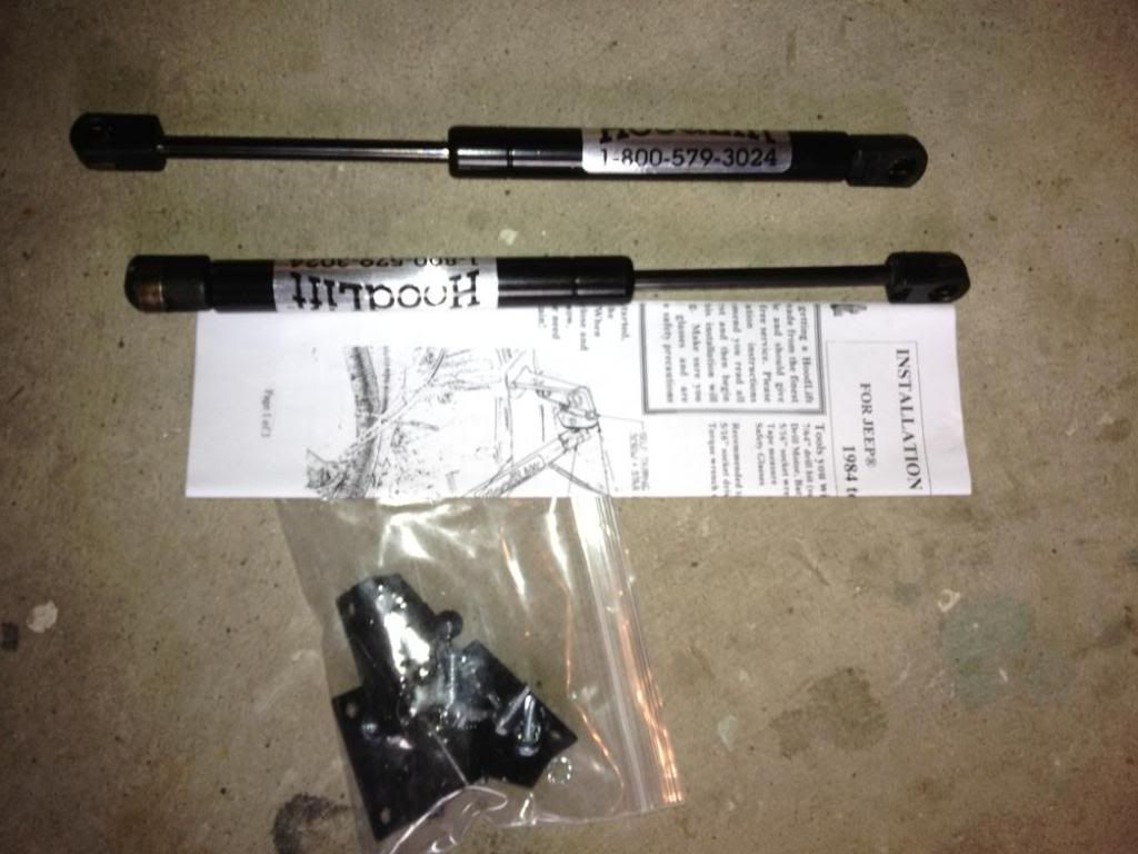

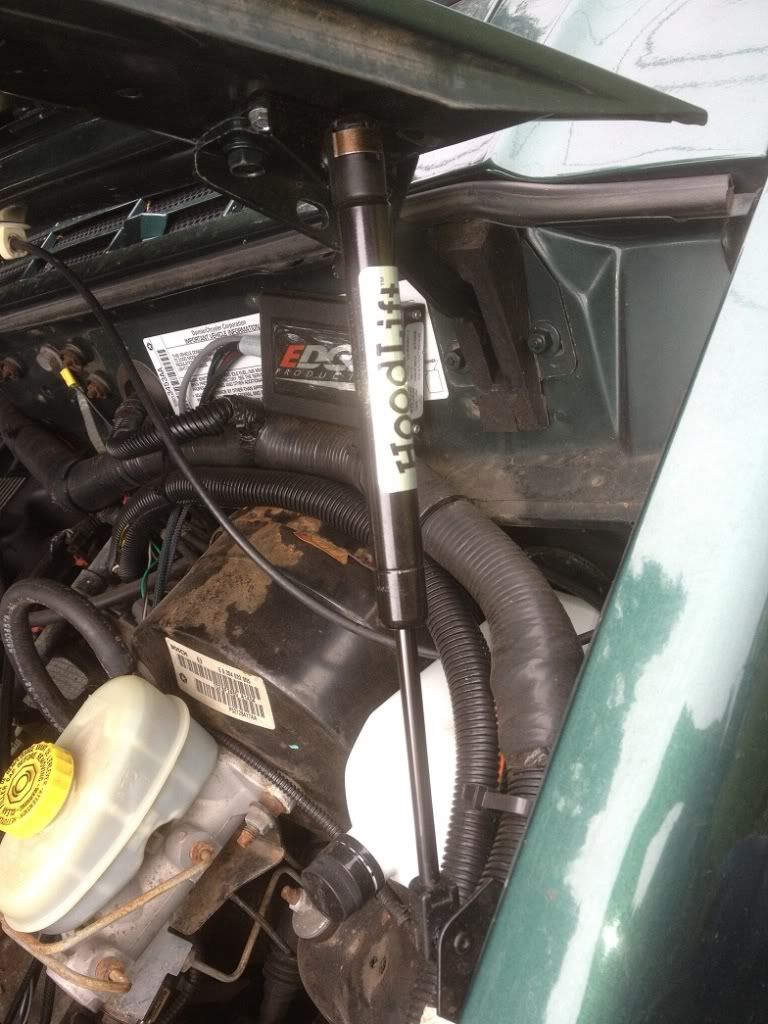

Being i was under the hood alot i bought some Hood Lift supports

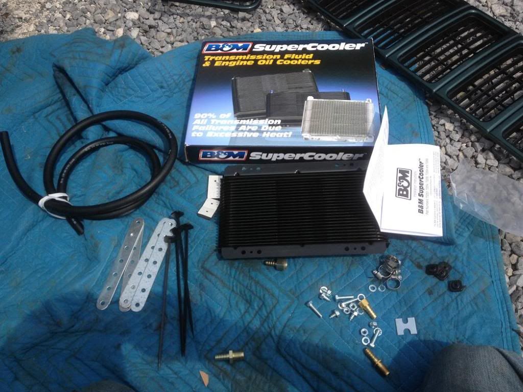

B&M Tranny cooler ( will take pic of grill off later, so you can see how its mounted )

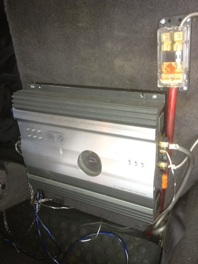

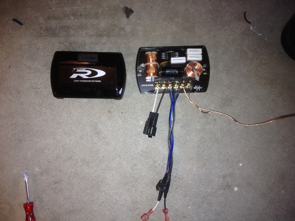

Car Audio
- Alpine Head unit
- 5 1/4 Alpine type R Speakers Front doors/rear sound bar
- Alpine type R Tweeters in Front doors
- Factory Infinity Door tweeters ( need paint still )
- 0 Gauge wire
- Old School alpine amp
- 2 10'' Kicker comps in single ported boxes

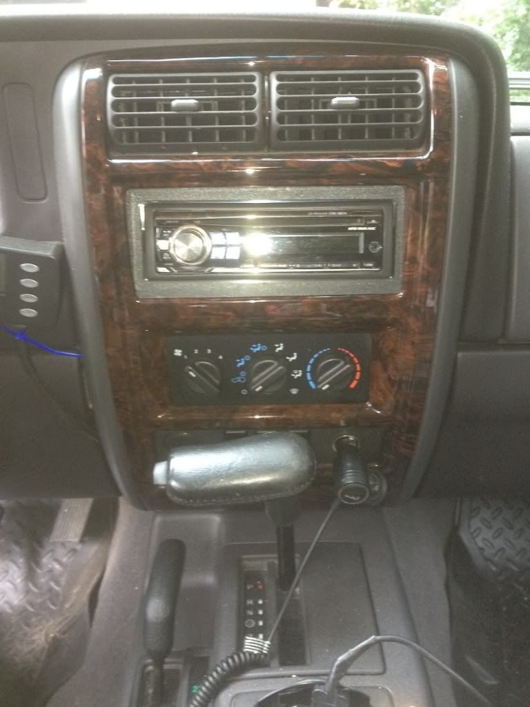

Scored a wood grain bezel from the JY

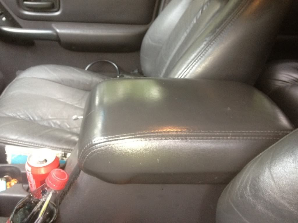

Installed 98 5.9 leather shifter knob, Center console lid

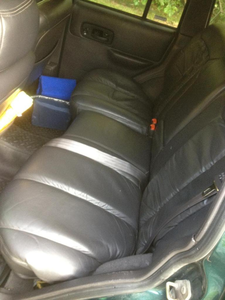

Hated my original manual cloth seats and found a good deal on some leather seats
98 5.9 Leather front/rear seat swap
Rears were not too bad, alot of good write ups on here
Finished product after 4 hours on the rear
Fronts were not easy and took about 8 hours total
used the electric seat tracks from the zj, involved some cutting/ welding but overall was worth it

Is the leather shift knob from a grand? I want one but didn't know XJs ever had them.

How long are your hood lift struts end to end I've been thinking about fabing my own?
Hey it's from a grand Cherokee I like how it's more beefier then the stock zj. To install just take your old one off and pound the new one on ( I used a rubber mallet )

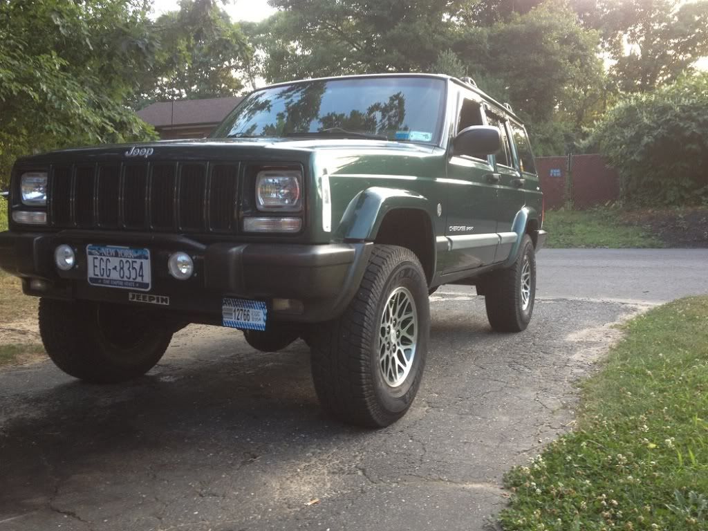

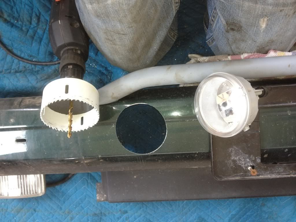

Bought some jk fog lights and installed them in my front bumper, Would have looked cleaner with out the screws showing, but will buy some caps to go over them
Also painted light bar, and bumper caps
Some toggle switches for the fog lights and the other 2 are for future installs

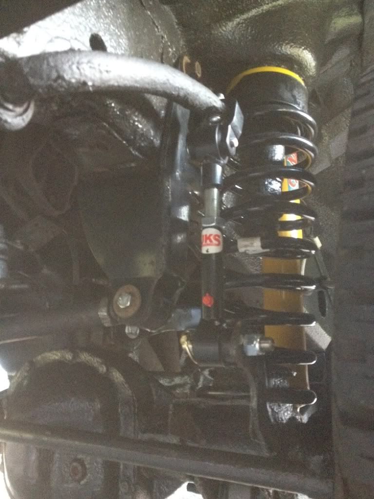

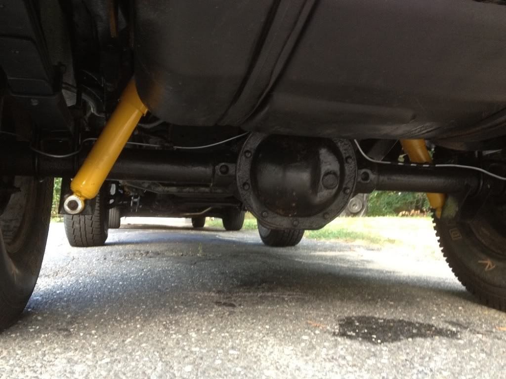

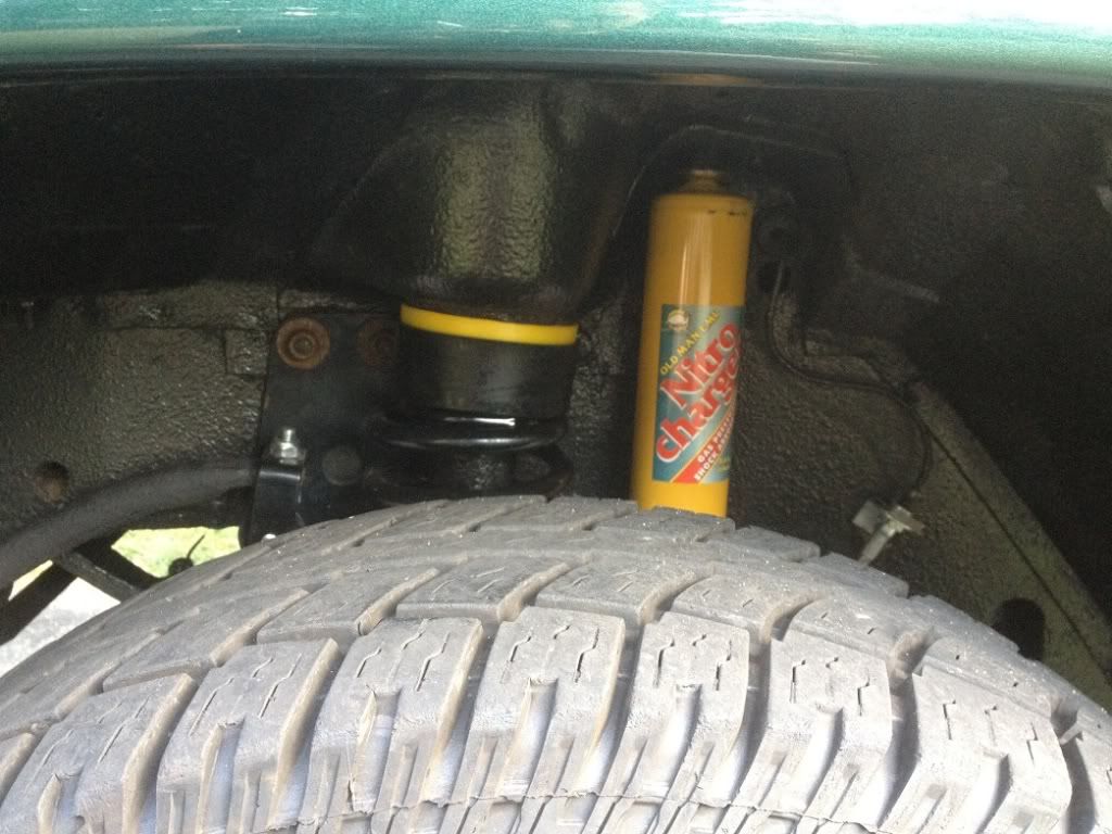

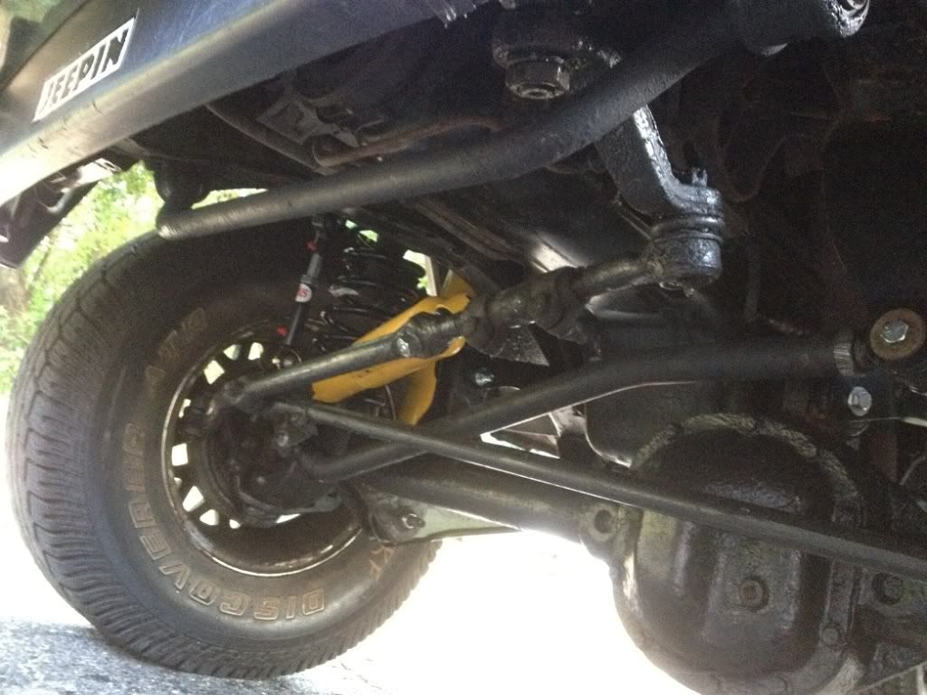

Finally installed and finished my lift kit on friday
3'' Old man emu coils and full leaf packs
Old man emu shocks and steering stabilizer
Old man emu coil isolaters
JKS quick discos
Rubricon Express front brake lines
Iro Double shear bar conversion
All New factory control arms
31x10.50 cooper discovery on stock orvis rims
Here are some pics
Hit the beach the day after and she performed great
Still need to order t-case drop since i have some minor vibes, 1'' rear shackles so it sits level and possibly wheel spacers

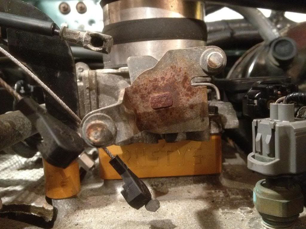

aaah S#^T me and a buddy did some light off roading on the island and i hit the water a little too quick and stalled my engine, after a quick turn to the key and no good, i quickly checked the valve cover and it was already milky, and the intake manifold was full of water
hopefully after i pull the plugs and blow the water out and change the oil she will be good to go,
After tonight i would not recomend the K&N intake or the filter sleeve which is suppost to be water proof
bummer

dude that sucks! But in no way is that filter waterproof. Stock air box is more waterproof because the intake is below the filter. If it stalled, then you cranked it again, im seeing some bent rods in your future

Haha thanks and I got the plugs and tb off during lunch. Just gotta get some of the water out of the tb and new plugs and hope
For the best...... If all looks good. Will have a snorkel by next week lol. They got a good deal on them on eBay for 130 shipped

sweet after fresh plugs, and sucking all the water out she started up and purred like a kitten, gotta do a few oil changes to get the muck out but should be good. Man when the water cam out of the spark plugs it was like a rocket lol, will upload the video later
snorkel is on its way, thought it was 130 but it was 150 shipped :/ not the end of the world and alot cheaper then a rebuild

Just did the grand cherokee v8 tie rod bar and steering linkage swap, since my buddy bent mine thinking it was a good place to pull me out Noobs, but what are ya going to do
easy sway and deffently a beefier tie rod bar

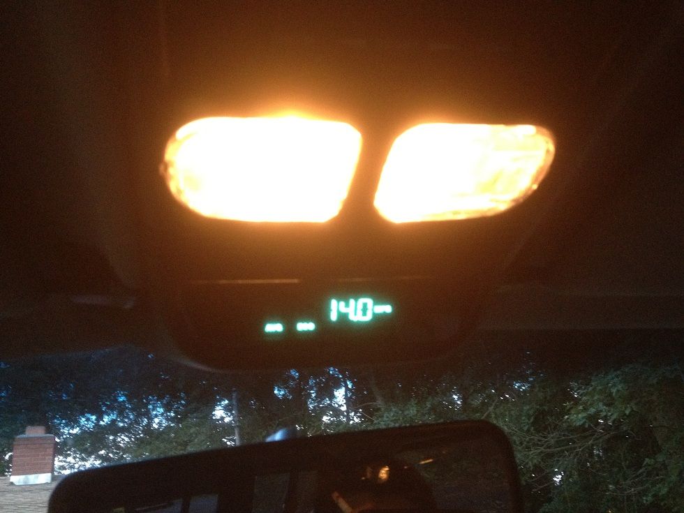

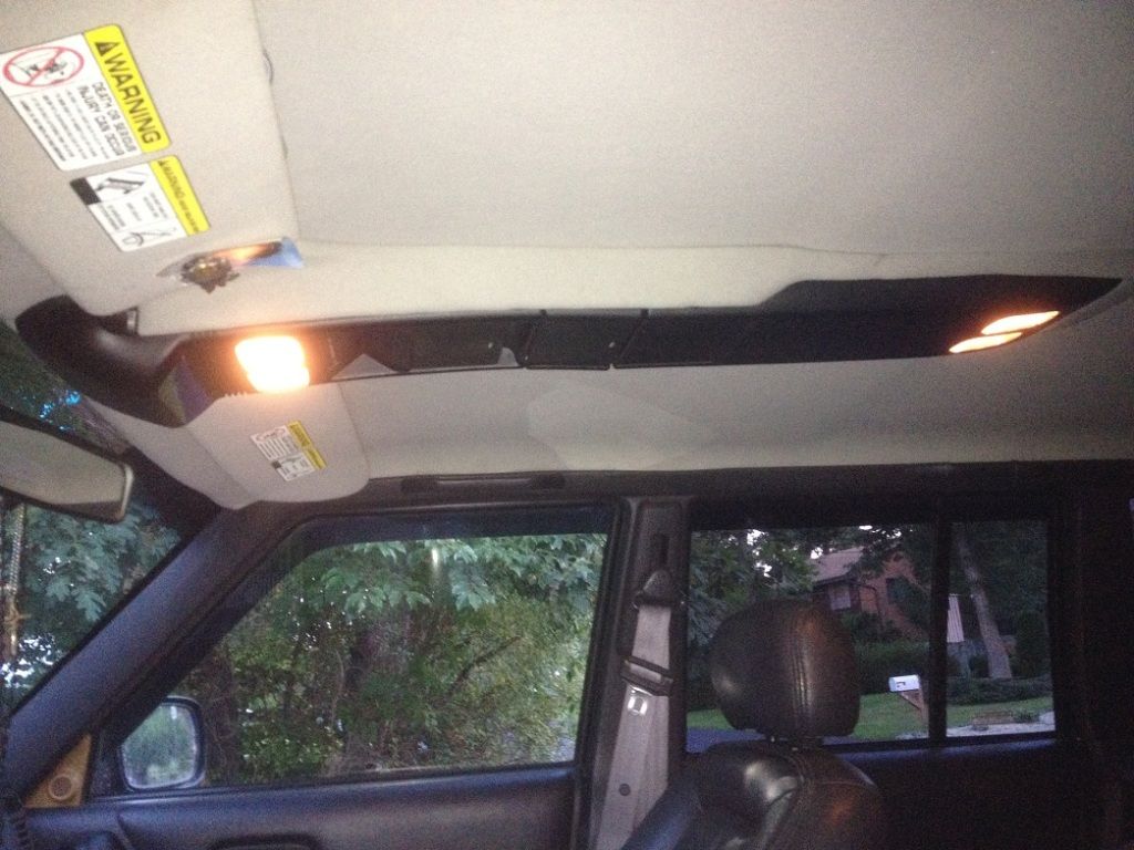

Installed a factory overhead console ( easy install and took about 35 min )
