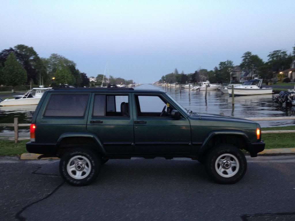

here is a before picture of my jeep. After picture will follow most likely tomorrow.

Posts: 73
This is after painting the bumpers, new hubcap, new header panel, fixed the drivers side electric window, replaced the heater core, valve cover gasket, replaced the headliner (pictures to follow), painted over the badges, 3 inch lift, 1 inch transfer case drop.....and I find myself asking......why?
SpecialK2000 is offline

Posts: 35,202
Time for some bigger tires.With the t case drop,if you just loosen one side and remove the other side nothing can/will shift and cause those problems aligning the holes.
