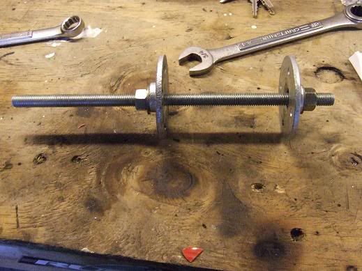

Here's another option. Go to your local Lowes or Home Depot and pickup a few things. A section of 1/2" threaded rod, some 1/2" bolts and washers, and two floor mounts for pipe (I think I found them in the plumbing area). Basically anything that is wider than the bushing, has a hole in it, and is flat will work. Here's my receipt....You may already have some of this stuff laying around in your garage.
Heres what it should look like assembled.

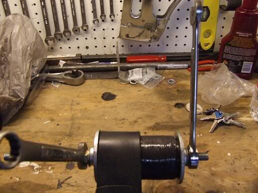

Place the bushing up against the spring, run the threaded rod through the bushing and spring, and re-assemble the makeshift press. Hand tighten the bolts until the side plates meet the bushing. Make sure the bushing is sitting evenly in the spring. You may want to grease the outside of the bushing to help smooth it through the spring. You should get something like this.

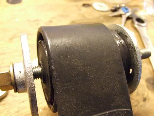

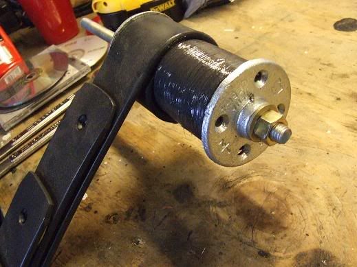

Go ahead and slowly tighten the bolts. It will compress the plates and press the bushing in. Make sure it's going in evenly.
Eventualy the bushing will make contact with the outside plate. At this point, you will need to remove the makeshift press from the spring.

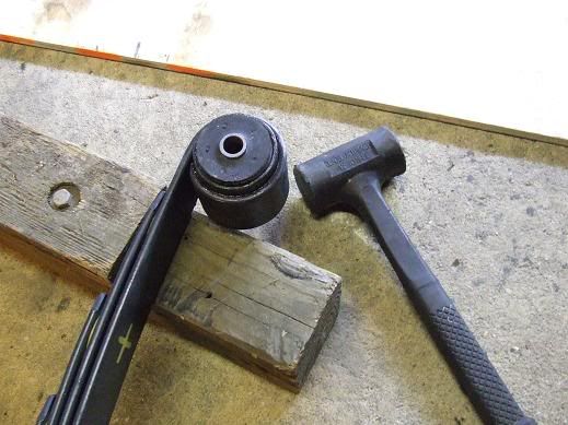

Now grab yourself a dead blow hammer and tap the bushing lightly until it sits evenly in the spring. Grab the next spring and repeat.
