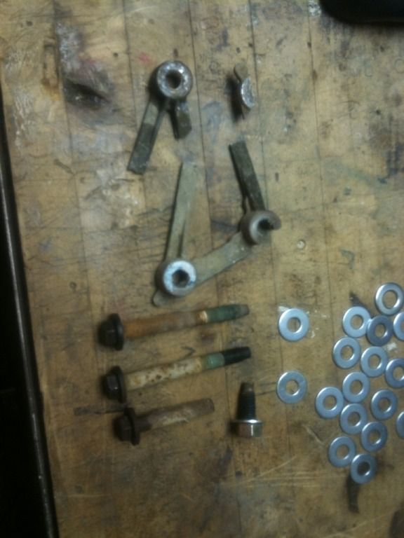

That "Bang" might of been your steering box brace snapping into about a million pieces.
Shaking the tire is not a test for u-joints, that will show you any play in the ball joints or wheel bearings. (which you seem to also have.)

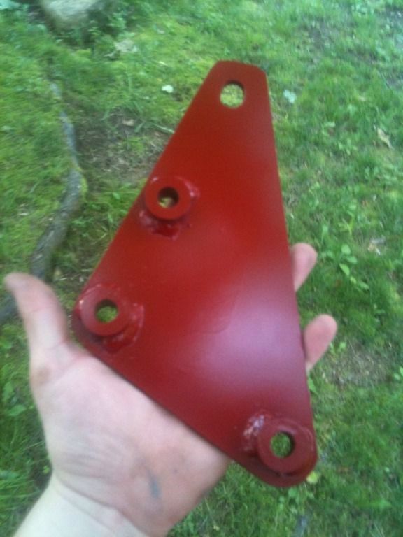

Here is a picture of my steering box brace when i pulled it out to replace it with a beefed up one. Notice it's broken in three pieces. Second picture is a JCR Steering brace.

Were you still able to operate the vehicle when yours broke? Cause I can still turn, it's just super loose and the steering gear rotates when I turn the steering wheel, like it's not attached to anything but the steering rod and linkage. So your theory might be correct if you were still able to turn when yours broke.
Yes. Just as you explained the steering box has a bunch of play because there is no brace there for it to brace against.
The box kind of tilted as i turned the wheel and seemed to stop tilting when the box came into contact with the unibody.
The unibody is actually known to crack there as well so you might want to check that out as well.

Depending on how bad it is (if it's only in the steering box area) you can weld that sucker up and order and steering box brace and a steering plate while you're at it. It will sandwich the cracked uni-body in-between them and should be fine.
JCR offers both for around $100 or so. Obviously there are others as well.

Make sure yours is actually cracked before you replace it. Even if it isn't - i'd replace it anyways. Don't even bother changing that out for a stock one. Even if you could find one i bet the JCR one is around the same price.
