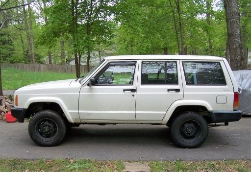

Finished...took all weekend to get both the front and rear, but worth it.
Envy all you people with air tools and garages. All I have is a driveway, portable canopy and determination.
TC drop kit was not the right one for my Jeep, be looking into Plan B.
Before and After pictures.
BEFORE
AFTER
Yeah - I'm happy with the results. Definitely going to replace the leaf springs when I can save up the funds.

Yeah, but for what I had budget-wise the shackles was my best option.
BP would have been more work.
It took me all day Saturday just to get the front end done (it didn't help that the sway bar links both broke trying to remove them).
Sunday was spend on the rear end - along with making breakfast for the wife for Mother's Day and smoking two racks of ribs for her Mother's Day dinner.
Right now the idea of more work on the Jeep is not appealing. I've got muscle aches where I forgot I had muscles.

After putting 16" wheels/rims and installing new ProComp leaf springs I am real, real happy with the results...I mean 'dancing banana happy' happy.
