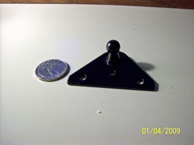

The PO of my XJ really butchered up those ball studs. I could not use them at all...and I couldn't get em out. So I cut them out and went to NAPA and got these:
I had to remove the plastic trim to get to the pillar to remove them. Even though I left a fairly ugly hole getting them out...these installed with a couple sheet metal screws. Ba-da-boom. They've been there for years...no problems since.

I picked those up yesterday at NAPA for $4.82 each, and installed them this morning. I like them better than the original studs, since the angle is more in line with the direction the support shocks are angled at.
