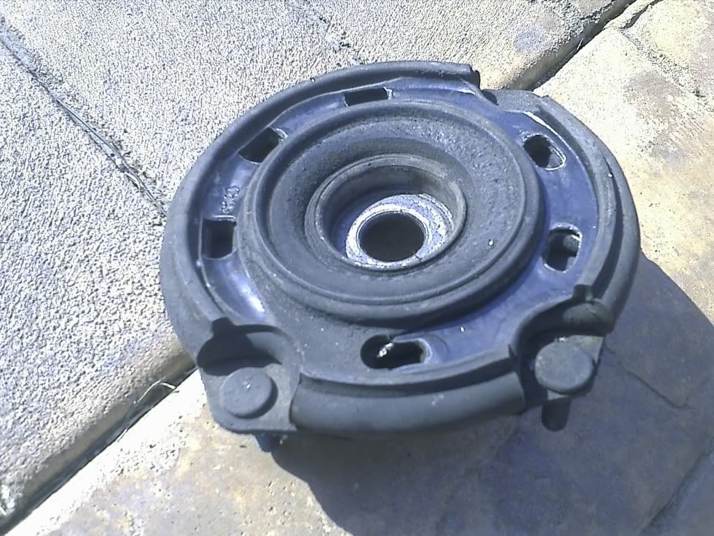

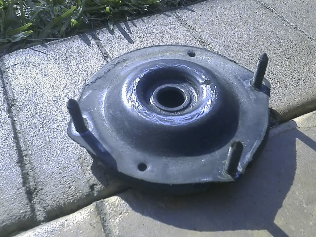

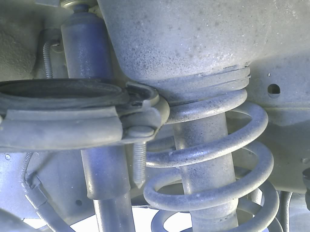

I got the thunderbird springs and the spring isolator for it because these springs have a larger diameter. I have to drill a hole down the middle, as stated by other threads on this subject, to 2.1". How exactly do you do this, because I have hole saw, and on the rubber side, theres too much friction, and there's nothing to center the bit on the opposite side.
pics
im plasma cutting the holes tomorrow. Everything seems to be coming together. I plan to do the lift on Saturday. Hopefully it turns out well. I'm doing the sway bar pin eliminators, thanks for the suggestion. PB Blasted everything today. Hopefully the hardware cooperates. Seems like its in real good condition, and they soaked on wd40 for the past 2 weeks. I'll probably paint my calipers and my drums the same color when I have everything off
