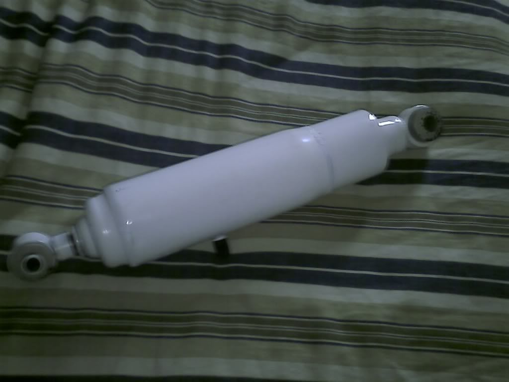

I'm not sure if i will need to fab bar pin eliminators with these new shocks. Heres a picture

you could have gotten some JK shocks (all four) for $30. I got mine for $20 but thats just cause my neighbor had some sittin around. less than 100 miles on them!
things you will need:
spring clamps for a 2.5" wide leaf spring. (autozone wont have, you need to order online or find an ACDelco near you)
S10 center pins
depending on the condition of your current u-bolts, you may need to get new ones as well.
PB blaster (penetrating oil) if you dont know why you need this, you shouldn't be doing this on your own.
things you dont need:
bar pin eliminators, just use the bar pins ones from your stock shocks. (use a press)
if you really want bar pin eliminators, you can use the axel-side mount for the rear sway bar link.

in some places, they call it a locator pin, but most just call it a center pin. and no, you need to have the S10 center pin because the hole on the S10 leafs is bigger, i personally saw the difference because i did this a month ago. so you will have to drill the locator hole bigger on your main XJ leaf.
ACDelco should have center pins. one location in my area didn't carry them so you should call them first and go to the right location the first time.
