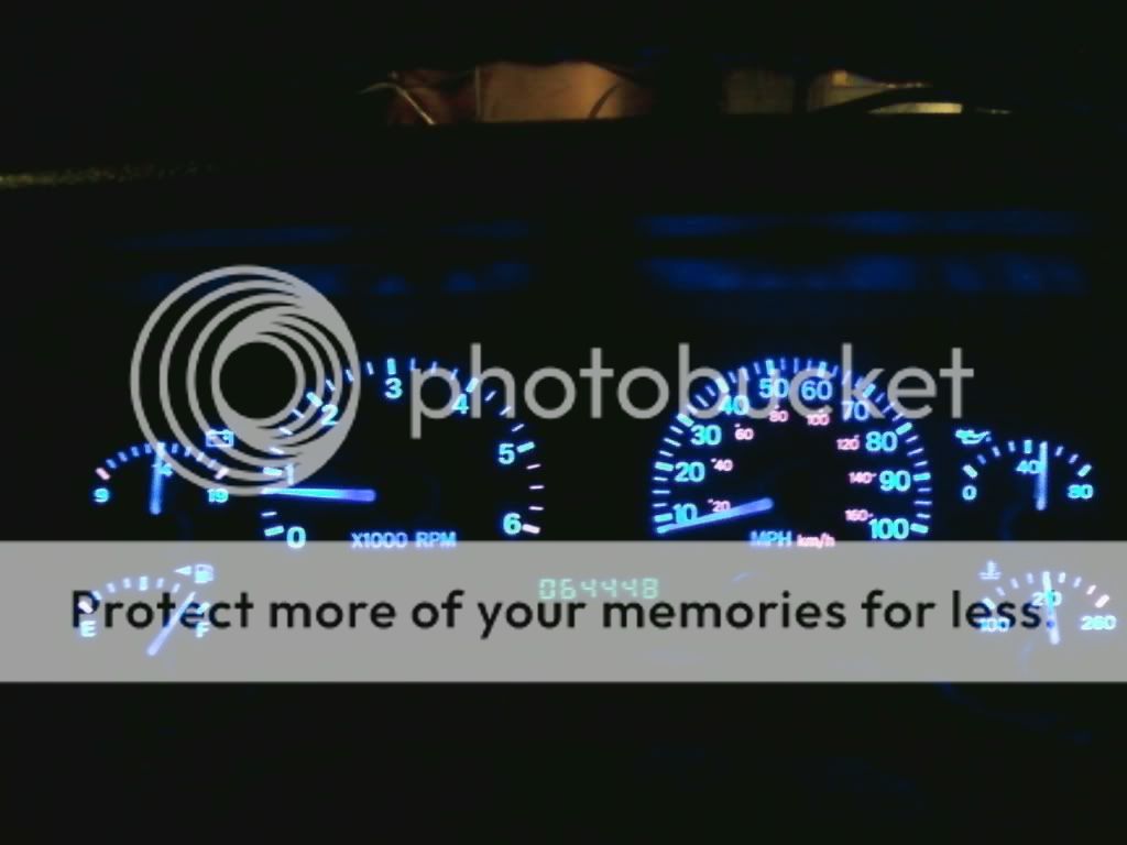

okay new lights! BEFORE
AFTER
and the whole dash

Originally Posted by Shanker67 View Post
My lights are in!!!
whatcha think?
Shanker, After looking at your lights it seams to me that you have two dull spots where the bulbs arnt glowing. I know it sucks but you might try and rotate the socket 180 Degrees and see what happens. Take a look at mine and then yours. You can see what I'm talking about

haha you know what a day after i put them it i was like ohhh my 2 middle ones aren't working! when they do work its gonna look even better! haha im glad you noticed it too, cause i was thinking maybe they just didn't distribute well in that area.
im takin my dash apart this weekend and im gonna fix them then

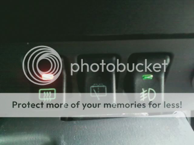

okay heres the fixed gauges!
Defrost, Rear Wiper, Fogs, Shifter and TC (TC needs to be cleaned up)
Fold some white paper over so its about 3-4 layers thick, cut it to fit and slide it under the clear part. Its a tight fit on the TC, so you might have to put the paper in one layer at time. And as a bonus it will look better during the day time too.
Looks good though.
