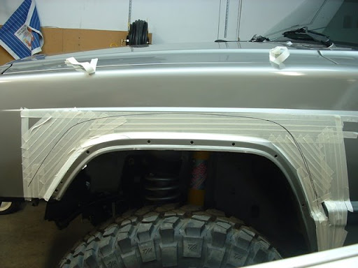

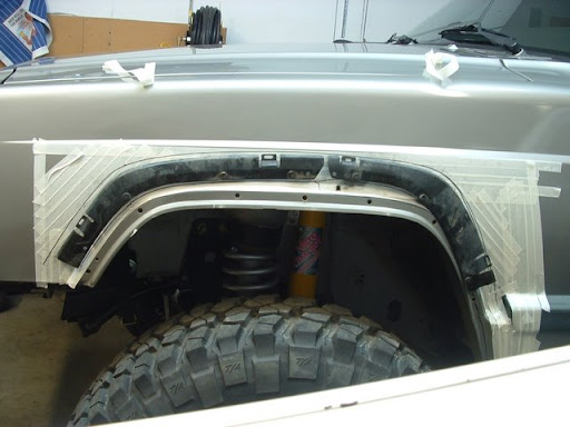

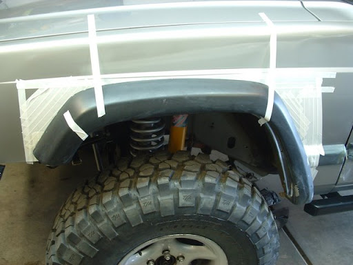

On to trimming the front fenders. So I like the stock look of the flares and wanted to retain the stock look while still having enough room to stuff the 33's.....I searched high and low for a good write up...surely this has been done with good results.......and it has!
A huge thanks and shout out to Nick Green, NAXJA memeber "53GUY" for doing it write with a great write up. If anyone wants to do the same here's his write up.
http://www.geocities.com/green6173/
Once again, I'll spare you the details.....
The flare taped into place for fitment......

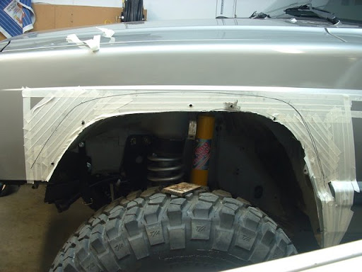

Draw a line around the top, so you know where you wanted it.....Mark where your flares new mounting holes will be......Drill, making sure not to drill a hole in your windshield washer resivoir.
Test fit the hardware to make sure your holes were good.....
Cut. I used a 4" grinder with cut off wheel...took about 38 seconds
Wallah. Minor trimming of the flare bottom was needed to fit flush against the fender.

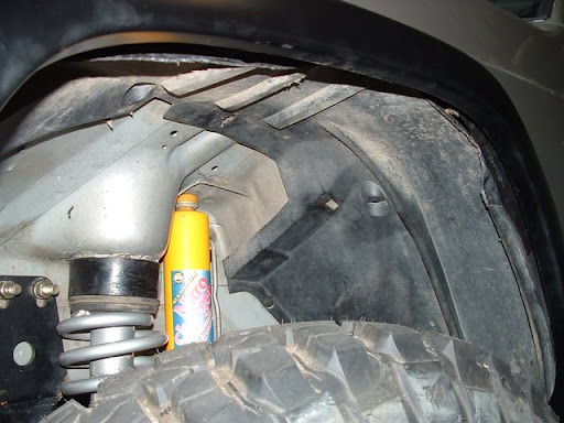

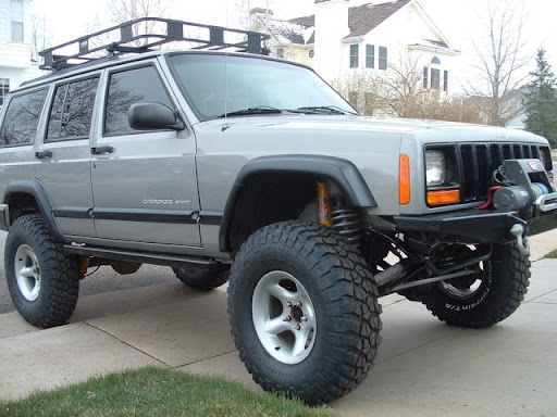

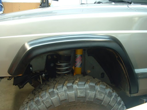

Now, I also wanted to re-use the inner wheel well liner.......it took a little doing...but I managed to get them trimmed down and in using all stock fasten points minus 1 or 2 that were cut off because of the custom bumper.
Fnished! I think it turned out great. I haven't flexed her yet to double check for rubing but the 33x10.50's fit in more snug the my 32x11.50's

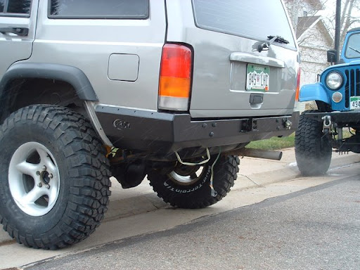

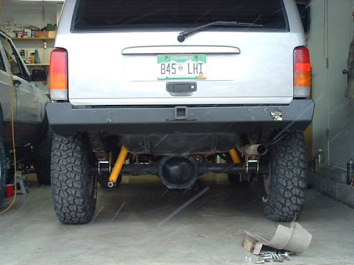

I also got my CROK bumper on......still need to do some minor trimming to get the rear wells to fit flush...but this is where it stands right now.
I also spent some time trying to get my pre-97 gas tank skid to fit the 2000. No dice. I cut about 8" off the front of the skid and it still won't fit. I diod notice the post97 tanks fit more snug to the XJ, better departure angle for sure.

That's one CLEAANNN Jeep... I really like the look of the Flares and wrap around rear bumper. You have a link to the bumper?
Cheers.
2000 XJ 4" 33's... TJ on 1 tons and 40's after Afghanistan!
Kpat is offline   Reply With Quote
Old 04-07-2009, 03:36 PM   #34
XJH-007
I drank what?
XJH-007's Avatar
Join Date: Mar 2005
Location: Morrison, Colorado
Posts: 4,674
Sure do.
I've beat on this thing pretty damn good.......and pull snowmobiles with it.....awesome product.
http://www.c-rok.com/Rearbumper.html

What flares did you use? How did you paint them?
Edit: Looks like stock flares, but did they get painted?
Yep, stock flares. HomeDepot Semi-gloss black.
