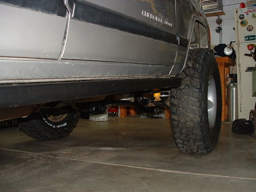

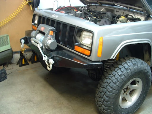

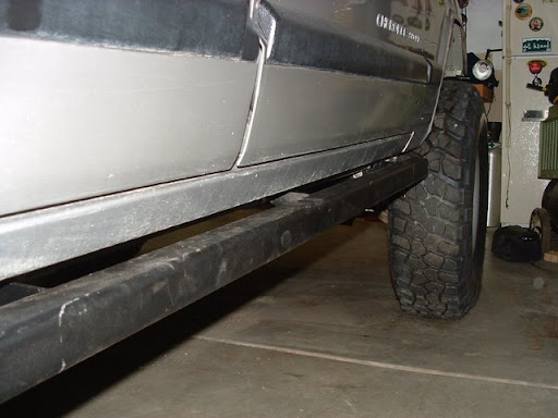

Registered User | Mid Week on Jeep Week. Sliders. The lower pinch seam has changed a bit from the pre 97+ XJ's. It took a couple of new bolt holes to get them to line up but they fit. I was originally going to block them out about an inch so I could use them for a step. They fit super snug to the older XJ....these seem to stick out about 3/4" more...so that was a bout perfect for me. Re-bent the original brake line and refastened it about 4" lower, cheap, easy, and free mod until I get my Y-link swapped over an need extended lines. Front Winch bumper actually fit the newer XJ better then the older ones. No fender trimming under the marker light, and all mounts were identical. The WARN sits a bit further away from the grill too (maybe 3/4") so it will be easier to get the cover on and off. The pre 97 put the winch literally right against the grill. .......and the soon to be April employee of the month......... Tonight-Friday will be Rear springs, and Custom C-Rok bumper. ![]() ![]() __________________ Scott-Crawlorado Native I have an addiction..... *00' XJ_T-n-T Y-Link/6" RE_OME's_33" KM2's Tera 4:1 / 4:56's_Elec. Locked D44 **84' CJ7 4"BDS 33's ***02 WJ Overland Last edited by XJH-007 : 04-01-2009 at 10:51 AM. |
