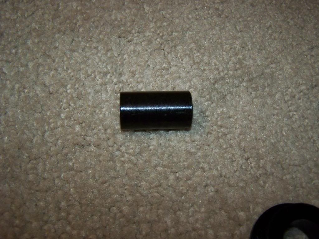

This is my review since i couldn't find any real info on it with pics. UPDATE ON PAGE 2
Well after finding this track bar on Iron Rock's website i decided to make a jump and buy one so i ordered this on Thursday and FedEx tried to deliver that Saturday customer service was great. the one issue that i had was with FedEx they requested someone 21 to sign for it and im only 19 but iron Rock tried to fix this issue but FedEx wouldn't compromise so i need to go with an old roommate since he could sign for it with me present WTF but other than that great transaction and people to deal with.
But from what i can tell about the track bar it very well made and the bushing are not flex joints but just normal bushing that if need replacing can be available at any auto parts store.
Here's a link to it http://www.ironrockoffroad.com/Merch...egory_Code=PFX
And time for picks
Ill update this thread ounce i put on my lift and this track bar

Since the axle is fixed by the control arms, it just moves up and down. The joints on either end just need to allow for up and down movement of the axle. The IronRock style of upper mounting is referred to as double shear bracket because the bracket secures both sides of the pivot and the bolt only holds it in place. This style is better than a tie-rod end or Heim Joint style track bar where the mounting bolt pinches the pivoting joint to the stock track bar bracket (single shear mounting). Tie Rod ends are not designed for this type of use and flexing the suspension can exceed the range of travel and damage the Tie Rod end.
