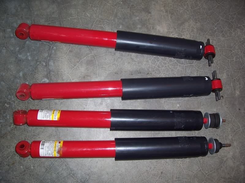

Here are my new $50.00 shocks:

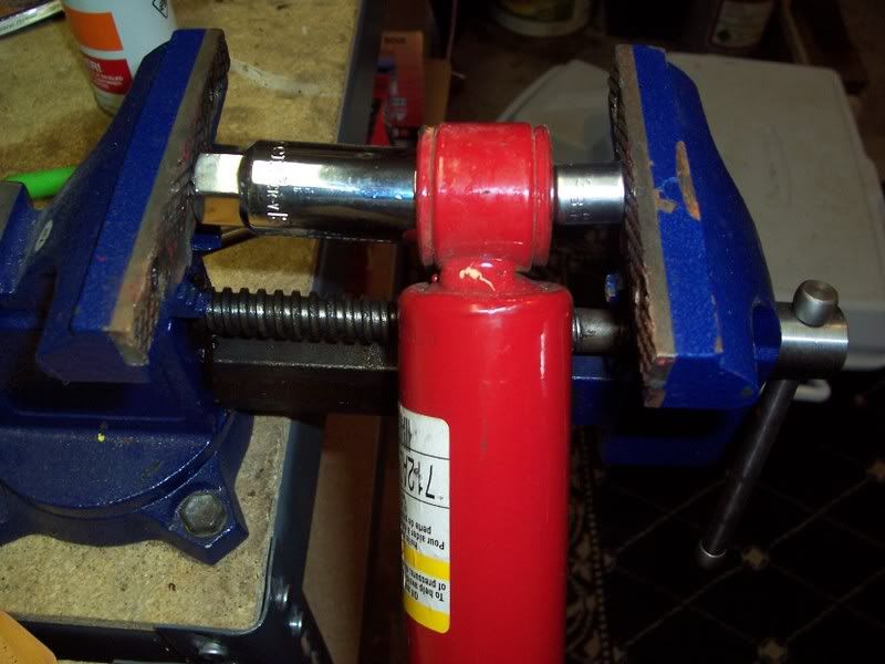

You will need to press out the metal collar on the lower shock mount of the Rubicon ones. I found the best way was to use a 4" extension and a spark plug socket. I placed these in my vise and cranked away (go both ways at first to avoid damaging the bushing):

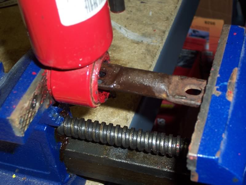

Once I had the metal collars out, I then pressed in the bar pins. I rounded off the sharp edge of the bar pins and then oiled it down. It took very little pressure to get through the bushing and I noticed no damage:

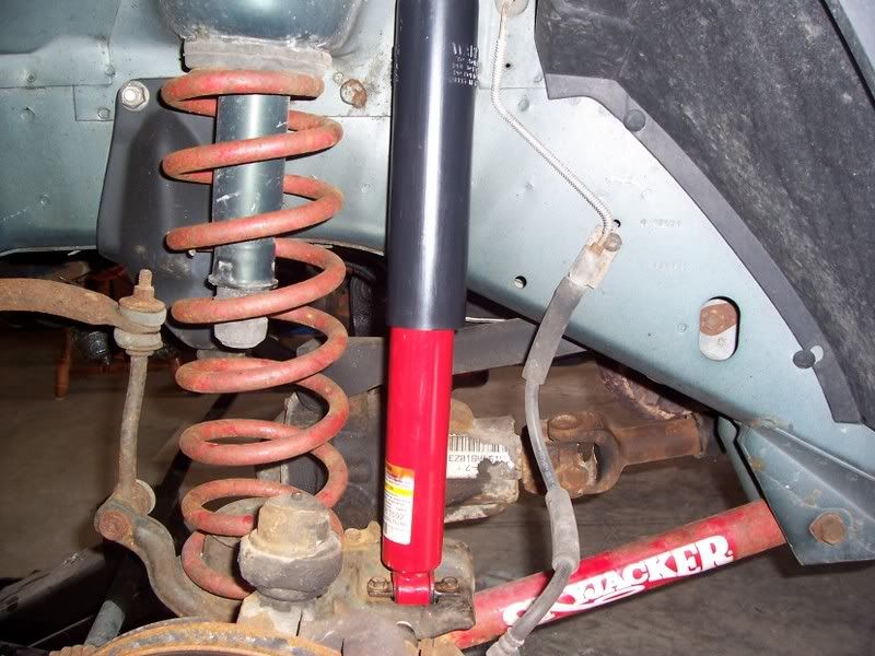

Once the bar pins were installed, I mounted up the new shocks:
