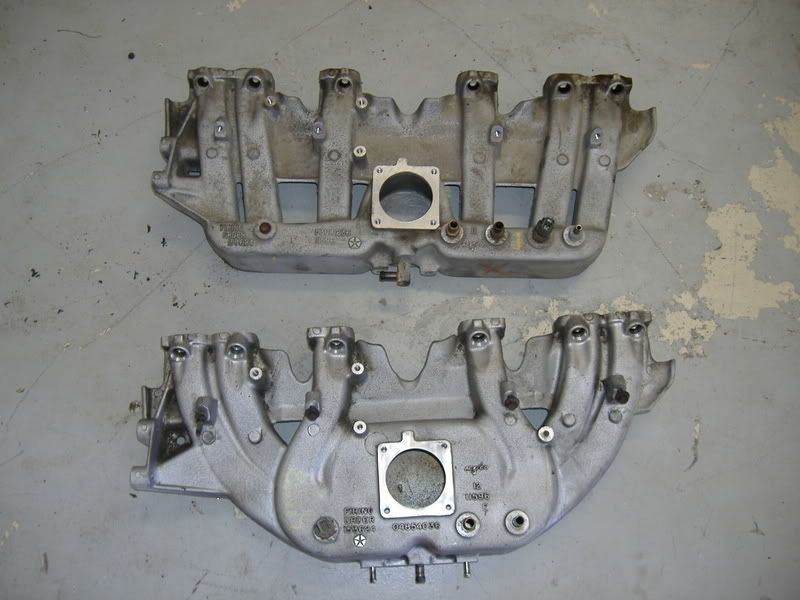

so, for those of you who are curious, or who havent seen the raw data, here is a pic. the top is your run-of-the-mill 4.0 log-style manifold, and the bottom is the '99-'01 manifold.
its really easy to tell how the small, thin plenum and unequal length runners (really short in the middle, REALLY long on the outside) are not as smooth or efficient of a system as the large plenum and nearly equal length runners of the newer model.
mine was $100 at the local junkyard (they sell em on ebay for $125) and $11 for the gasket.

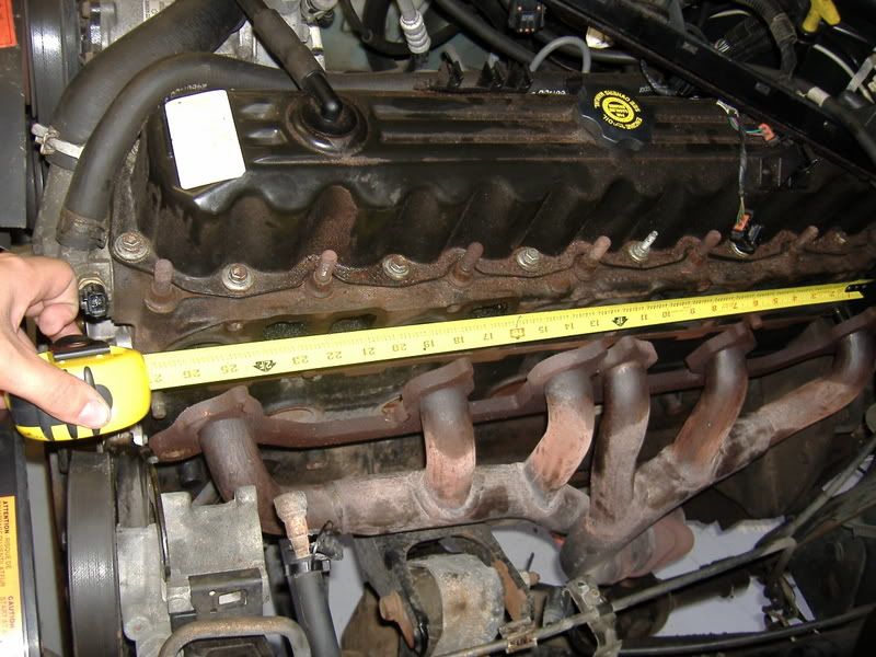

bottom pic shows how unimaginably long our engine blocks really are (they're ridiculous!) gasket is 27" back to front... thats just crazy...
