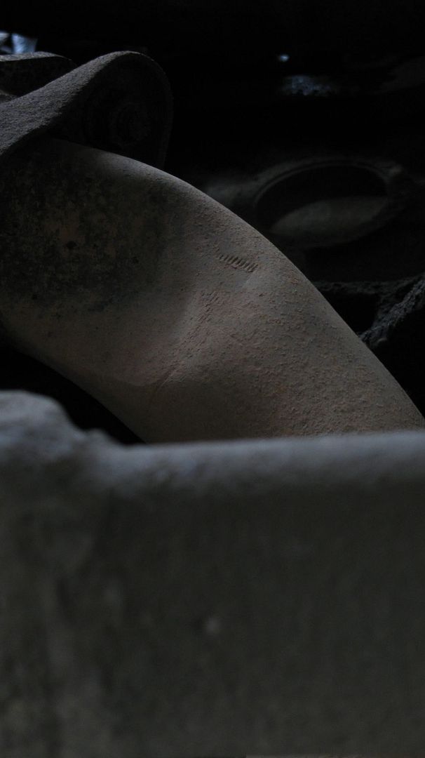

See picture and take your best guess because I have no idea what could have caused this. Its not even near anything thats strong enough to cause a dent in pipe like that...

that pic is so big it's hard to tell

picture is zoomed in a little too close

That is how it comes from factory. There is nothing wrong with your downpipe.

they are all that way. i dont know if it to increase back pressure or what, or maybe i am being too generous in trying to justify it?

Mine is like that too. I thought I crimped it from too much force trying to get my O2 sensor out.

The factory caused it. It's for frt axle clearance.

looks like a bolt print to me...any around it w/o me having to crawl under mine?

trust what they are saying it is factory, seen it on every XJ i been under.

It was put there by the factory so when the front axle flex's the driveshaft doesn't wear a hole in it or cause a noise that someone would complain about.
My Borla header didn't have the dent in the pipe in that area and my front axle had self clearanced it.
