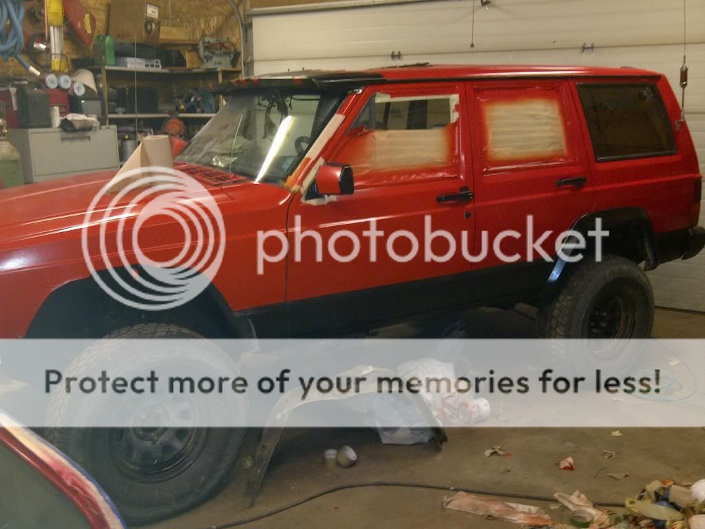

I wish I had have done this for my yj, To start its not orange yet, just tracking some progress and hoping to get some help along the way. Picked it up for $800, came with 31's, cb, tow pack, sunroof, 3.5" rough country I am assuming. I was a little late on pics already got started on the tear down.
Initial tear down.

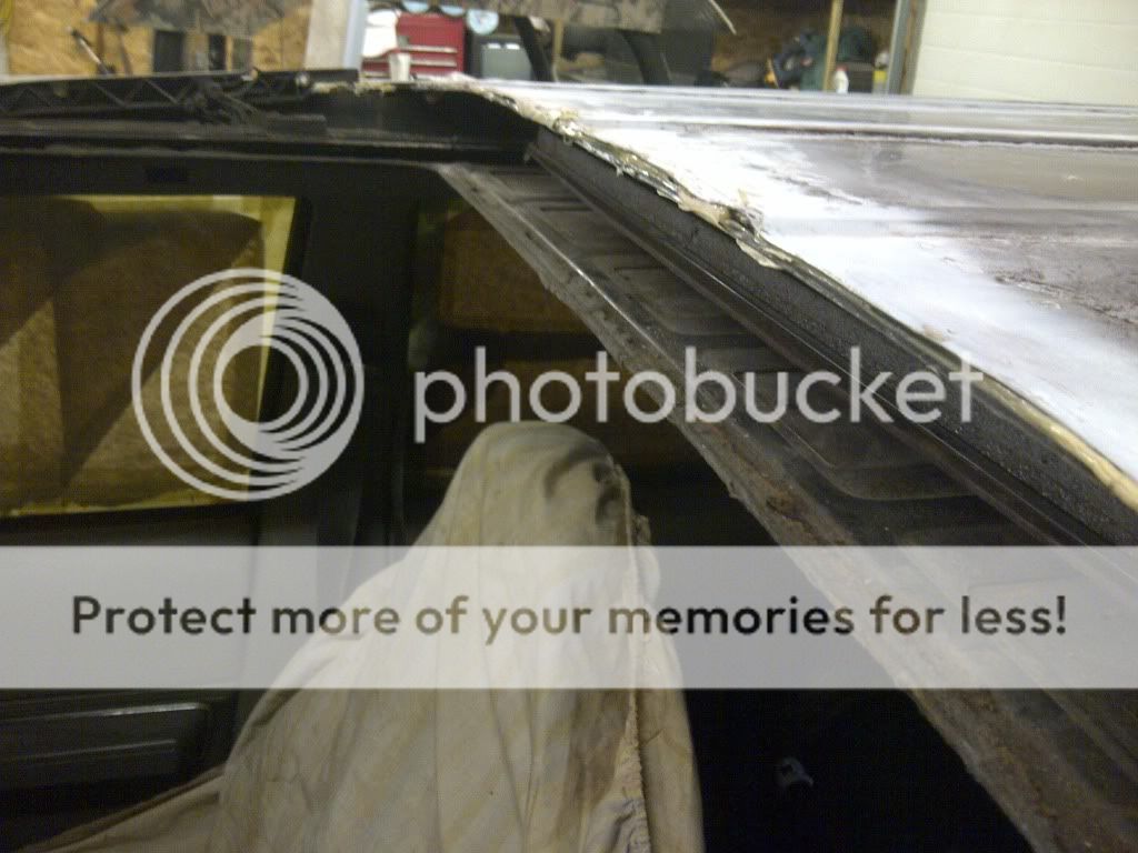

removed the sunroof, water was coming in through the roof racks and I want to seal the s**t out of it.

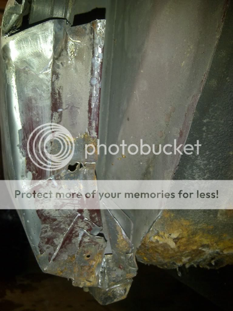

Started to take the front fenders to patch up what I thought was a couple little paint bubbles and found a cess pool of 23 years of dirt, salt and water.
And it looks worse without the plastic liner in the wheel well.
All rust and bad metal cut out and new ones patched in

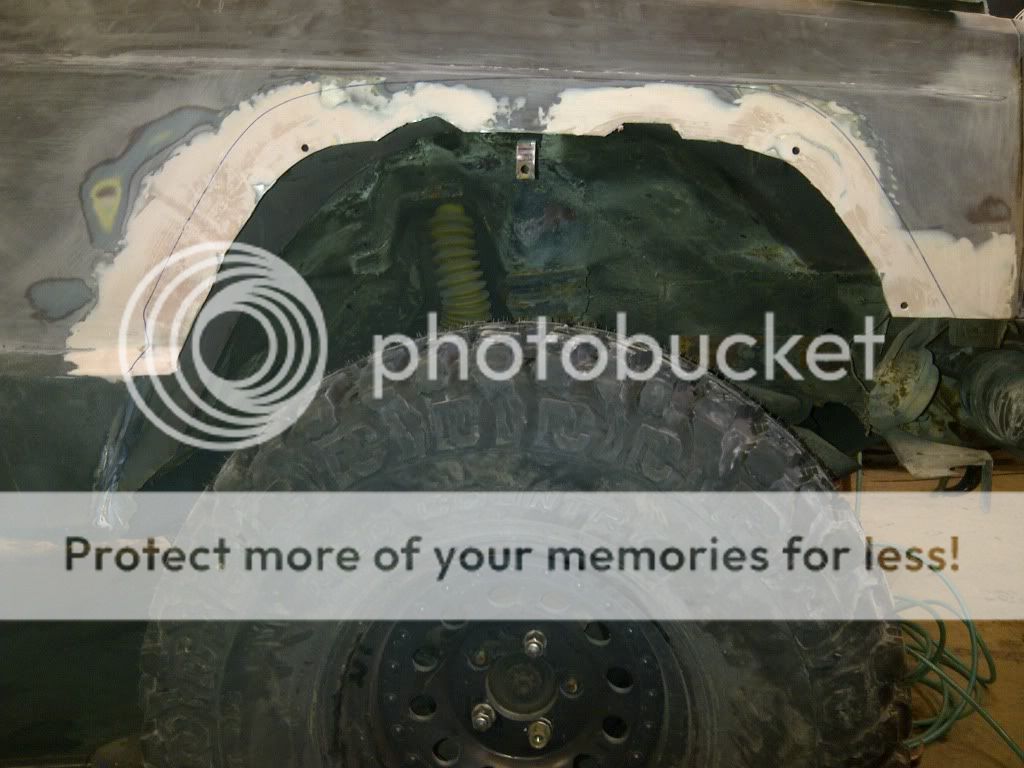

Since i will be moving up to 33's I cut out basically to the top of the bends in the original body panel, raising the flairs about 2"
And then tried a mock up fit, found out that theres still some more trimming for the from and then planning on cutting and folding the back

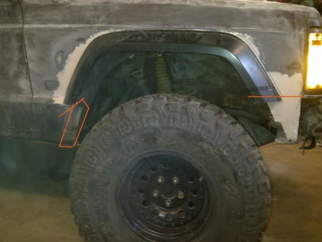

I would fold the rear tab circled in red over with a hammer before painting and cut the front part along the red line like the 97-up models if it were me.

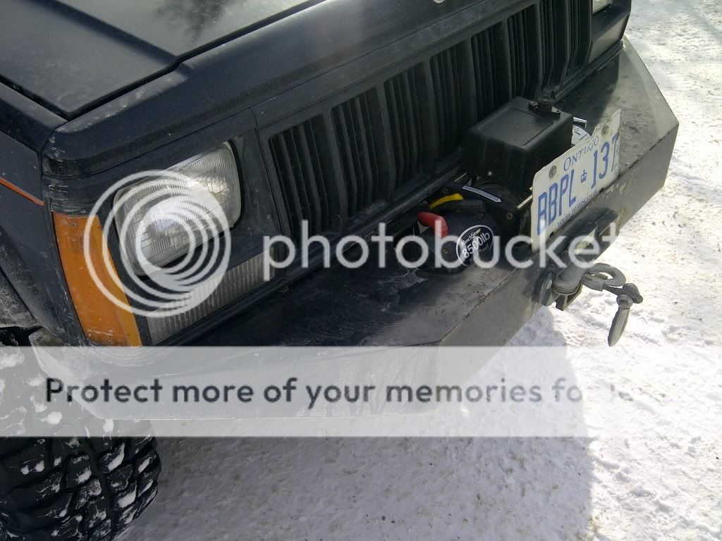

Will for sure be cutting the front fender along the line and starting the folding as soon as some space clears up in the garage, I will be moving my winch over from my yj and have a couple ideas for bumpers but i will post some pics with some progress

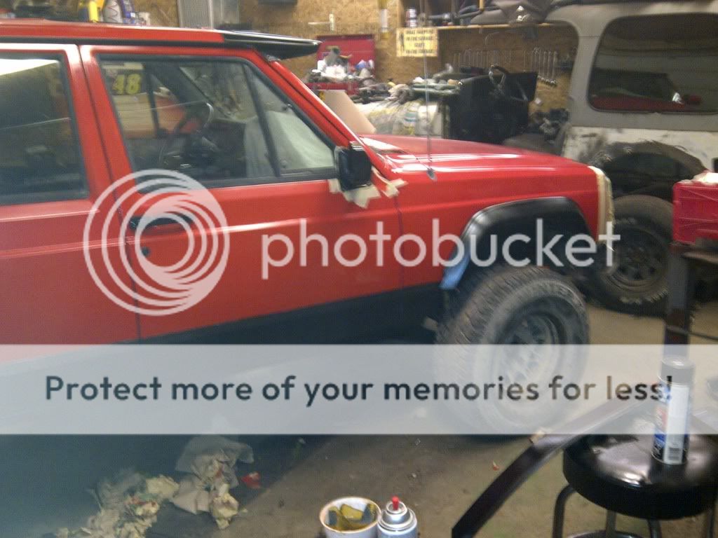

Just got in and thought i would throw in an update Finished cutting and folding the front fenders
This definitely tucks them in a lot nicer, at full steering doesn't touch, it might while flexing, but the tires that are going on are 12.5" on a 15x10 with 4.5" backspacing so I am hoping this relieves any future rubbing issues.

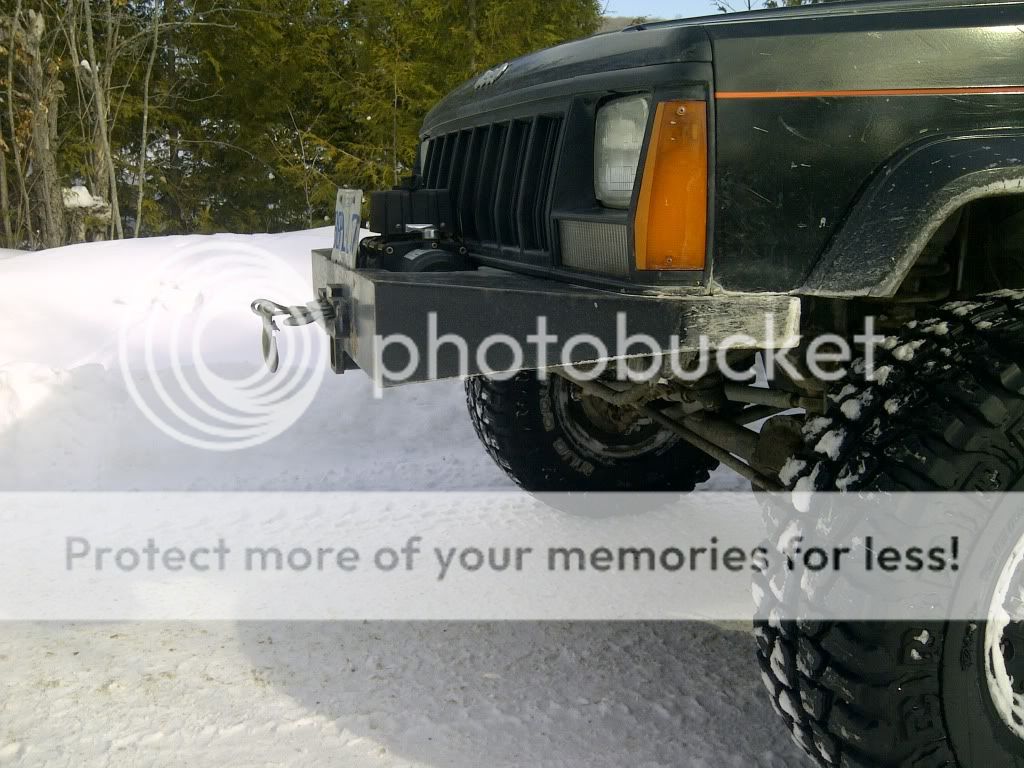

I also have a couple ideas for my front bumper, I want to clone my step dad's design, but make a couple changes

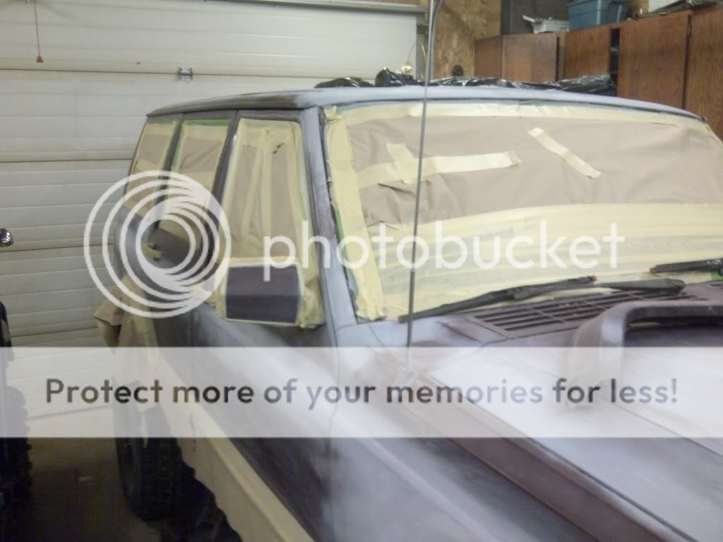

other than that just sanded, sanded and then sanded some more. Also a quick question for any paint/body experts, If there was some sun damage on the paint which resulted in the clear coat peeling off, (which has been sanded down) My question is there are specs that are clearly faded, if the clear coat is not compromised after sanding with 400 is there a possibility that they could damage the new top coat. I plan on doing at least two coats plus a candy clear coat.

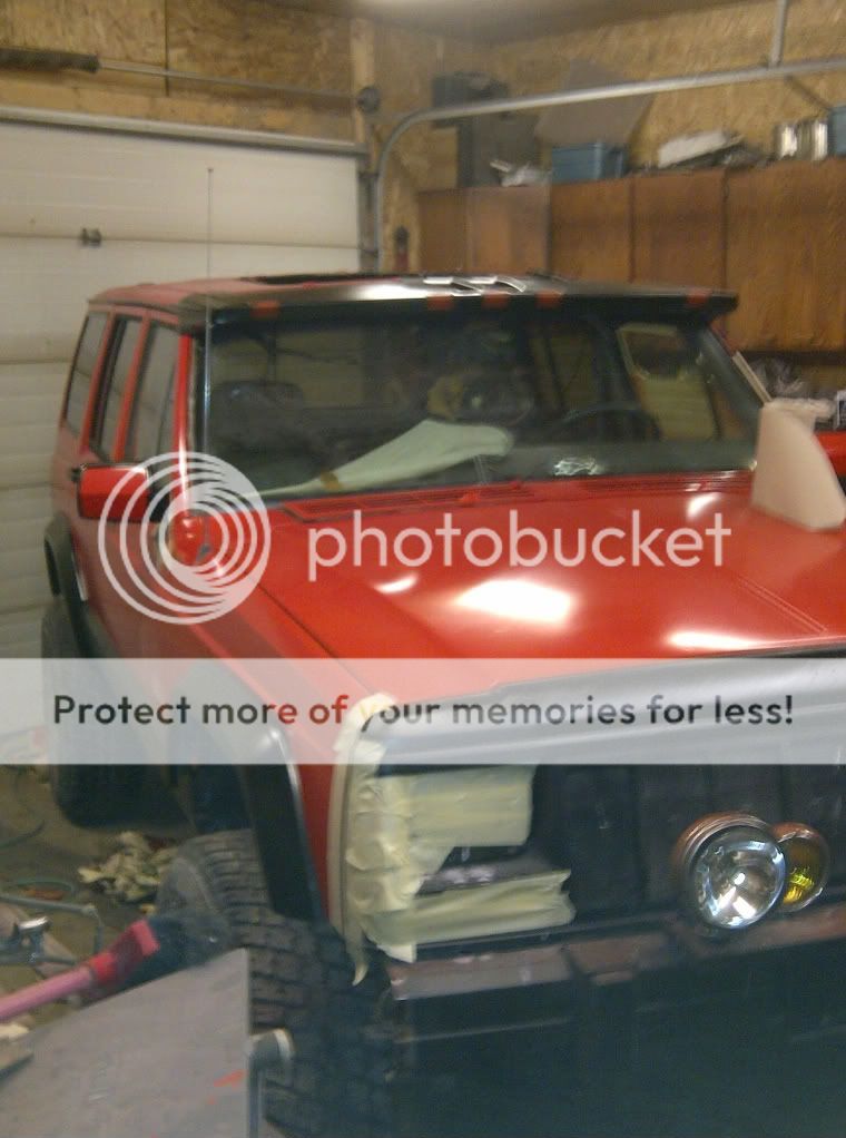

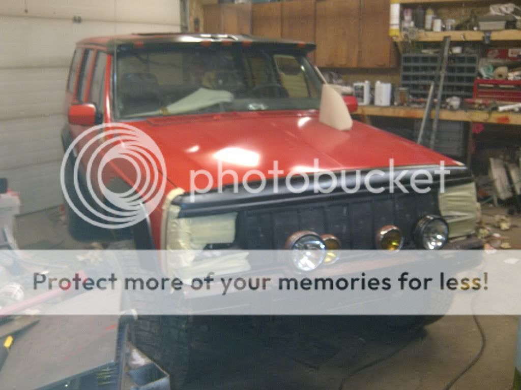

Finally got An update sorry it's taken a while had to get the yj into respectable condition before my rear bumper goes through the windshield of someone behind me.
sanded and primed filled all the timy blemishes with glazing putty
got the sunroof remounted with the aid of some broomsticks and good ol PL400 construction adhesive

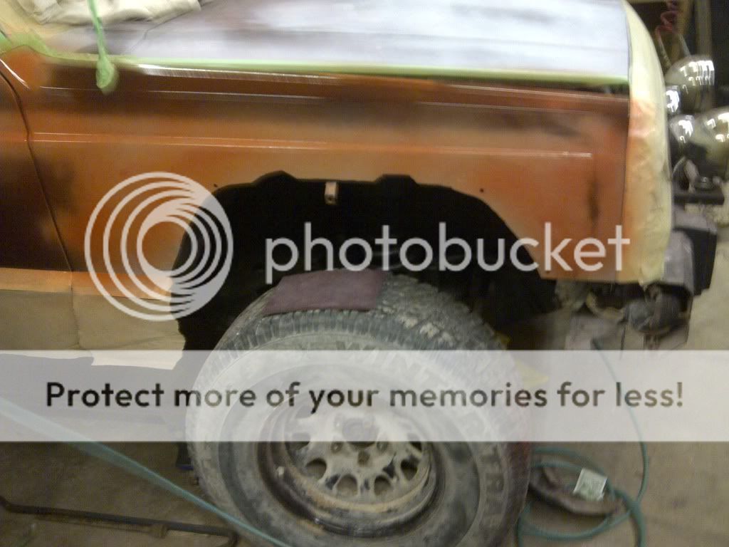

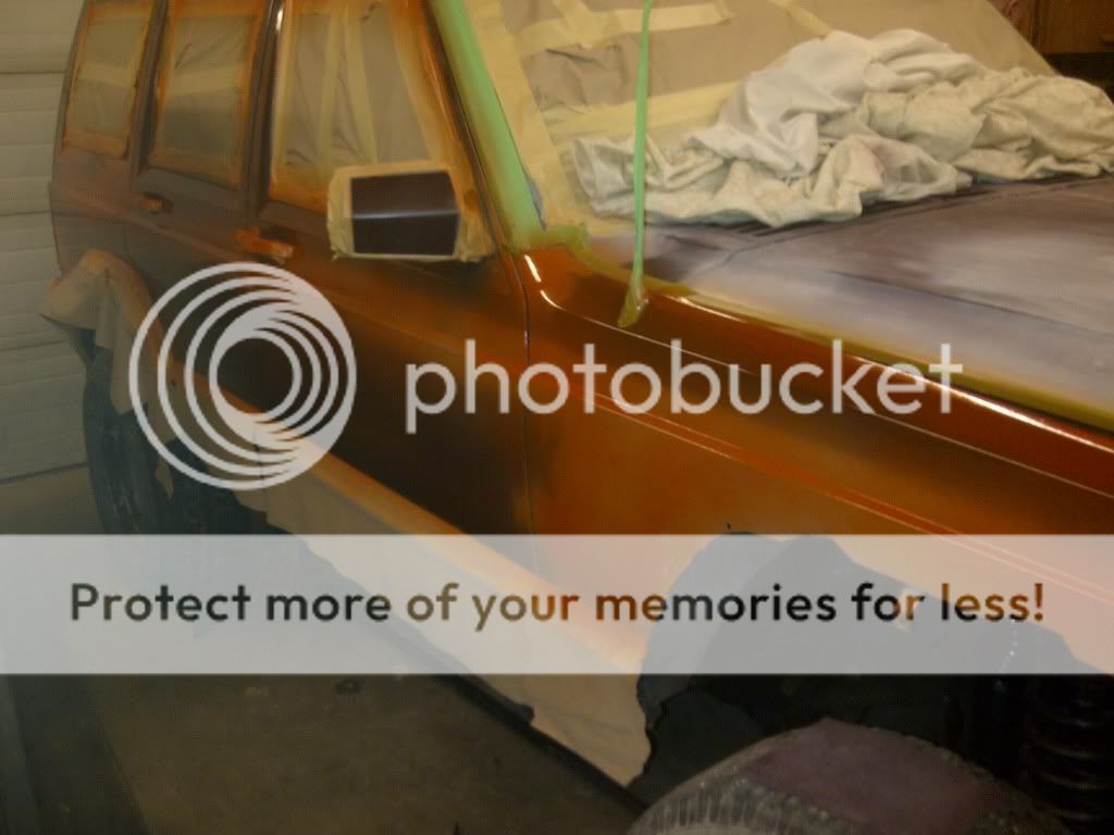

first light coat of orange down, can honestly say I was a little skeptical opf how good the coverage would be
AND BAMM 3 colour coat and 2 candy coats later you end up with this
Still have to take some pics of it out of the garage and with the roof completely put back together.

Thats a beautiful shade of red! Keep us updated on how she polishes out.
