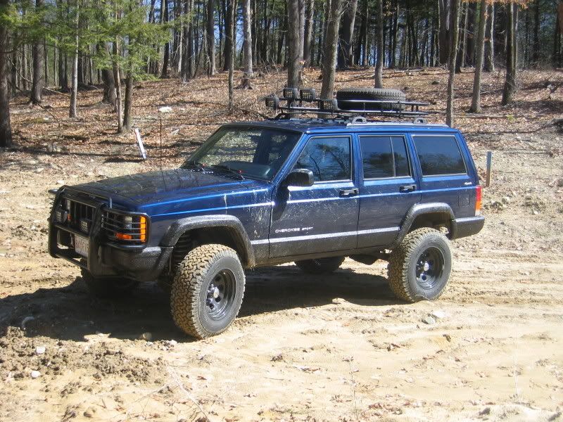

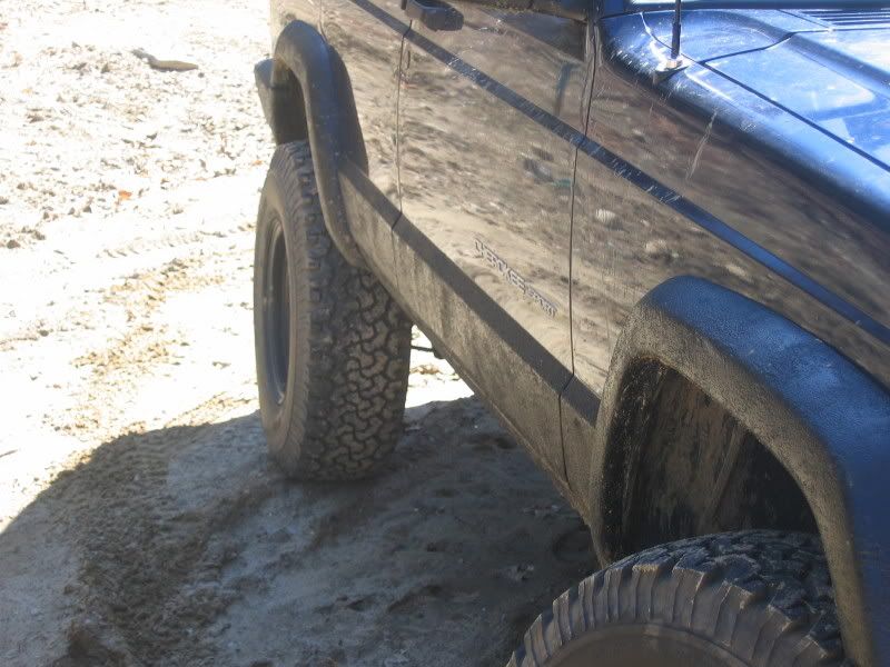

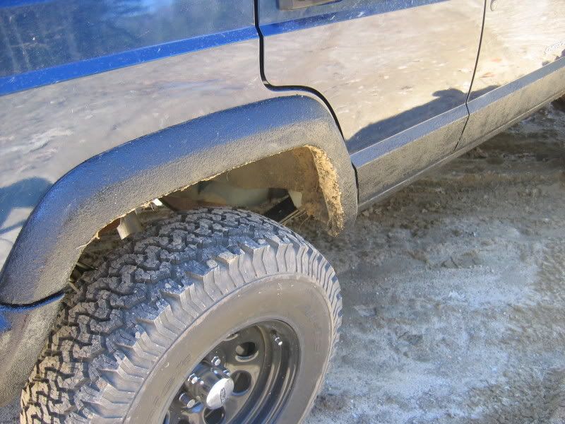

heres my herc' job, so far, i love it and its worked great, its saved me so many scratches, and i think it looks great too!!
heres the link to the herculiner process i went through
http://www.jeepforum.com/forum/f11/hurculing-rockers-402534/
