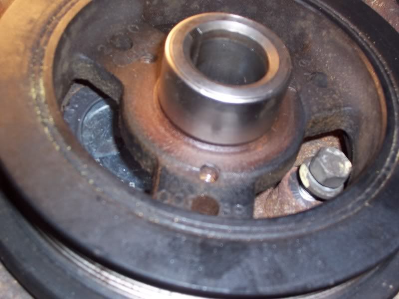

I installed the sleeve on mine when I replaced the engine. It is really not that hard to do.
After you remove the timing cover and put in a new seal, place the balancer in the freezer. When you are ready to put on the sleeve, place it in a pan of very hot water. Once it is nice and warm, remove the balancer from the freezer and slide the warm sleeve on to it. I had to use a flat block of soft wood and a rubber mallet to get it on all the way, but it did go.
Once it is on all the way, re-install your balancer (don't forget the little flat washer that goes behind the balancer). Here is a pic of the sleeve I installed::
