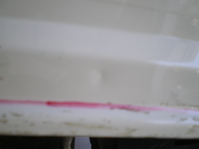

I knew I Didn't need much to clear the 33x1050 with 4" of lift.
here is my line in red
I used a 4.5" angle grinder to make the cut.
WARNING: these are rough cuts because I knew I was going to re-attach the factory flares. if you want a really clean look I suggest leaving a little metal past your intended line and sanding it the rest of the way

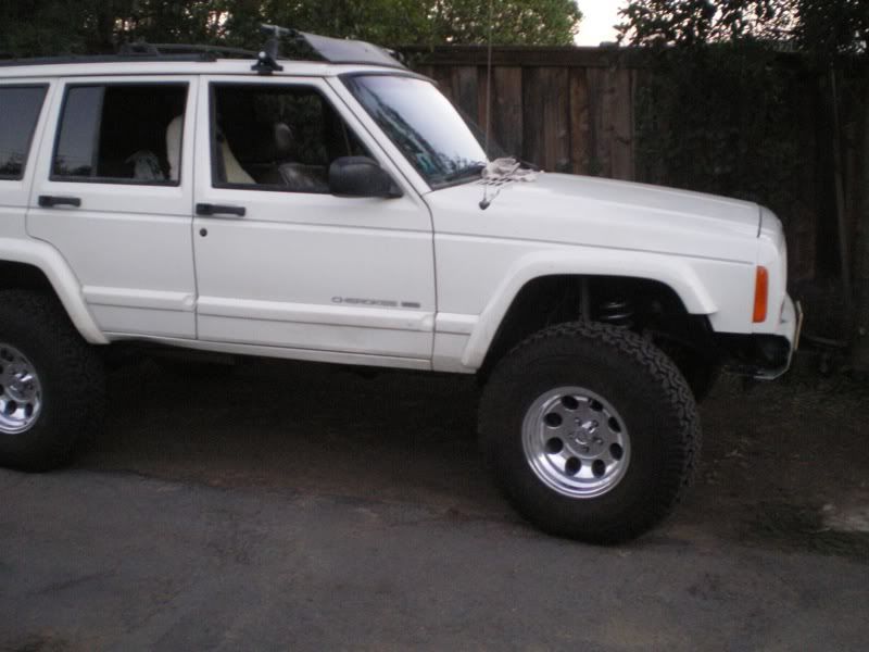

once the holes were drilled the flare was reattached slightly higher and further towards the rear.
here is where the top of the flare sits

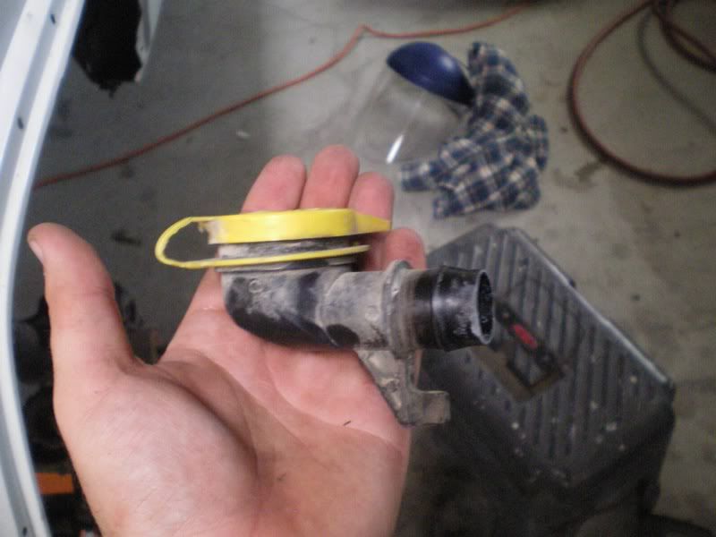

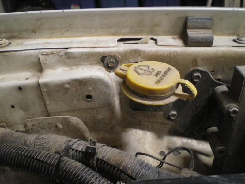

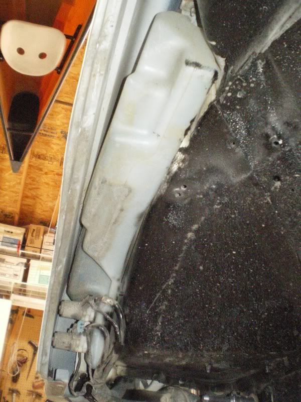

The only thing different on the drivers side is that on newer Cherokee's the Washer Bottle must be removed. temporarily
to remove it, remove the fill nozzle and the screw holding it in place
the fill nozzle removed. just pull it out (TWSS)
Then draw your line, or don't. and repeat.

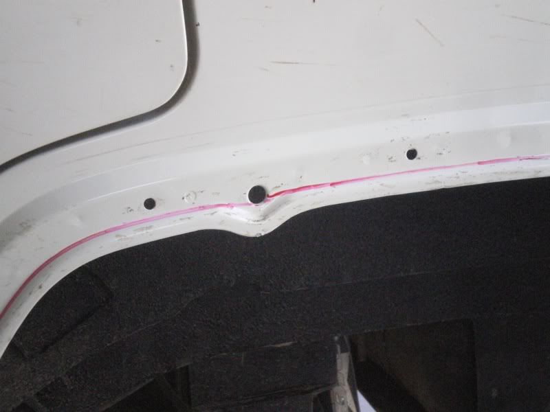

for the rear, I didn't need to gain much. so I cut just below the spot-welds, I trimmed a little bit of the plastic flares with a skil-saw and re-atttached them in the factory mounting location. just enough so it doesn't rub at full stuff.
the more you rub, the more you will need to trim.
DO NOT CUT THESE SPOT WELDS OFF.
the body will separate and the world will collapse into a black hole.
many people do the cut and fold- I didn't, Get over it.
here is my line
here is it in relation to the spot-weld
remember you are cutting through twice as much metal in the rear so it will take more time... or discs.
Here is the finished product.
a word of advice= cut slowly through the curves. unless you don't care.
