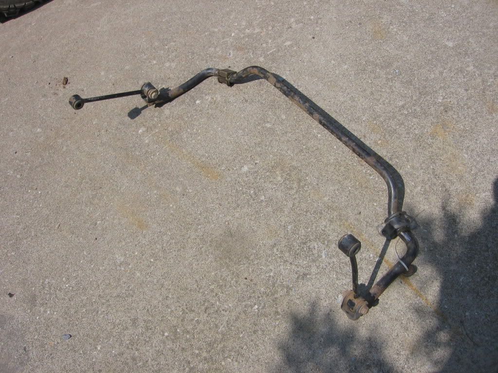

I got a sway bar for free today set up with longer endlinks. I know the guy and he just decided to take it off and said I could have it since he isn't gonna use it. My concern is that it may not fit on mine with a 3" lift. The guys cherokee it came off of I think has a 4 inch lift. The endlinks measure out to be 9 inches long and with the top bracket you see is another extra inch. So will it work?

Yes, it will work.

stock endlink is about 6". my JKS quicker discos measure 9" including the bracket and i have a 3" lift. i'd say go for it.

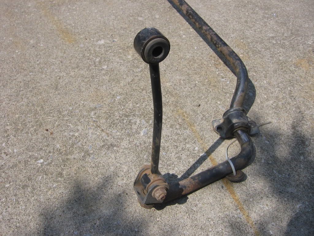

It looks like the endlink on the right is slightly bent

Now that you say that it does in those pics. It's down in my garage, I'll have to look in a little bit.

Went and looked and it is bent. That gonna cause a problem?

The lengths will be slightly different. You could try to take it off and straighten it.
Or, you can probably find a replacement link on Q-tec.

I could prob bend it back. Thanks guys. Prob gonna throw it on tomorrow then sometime make home made discos.
