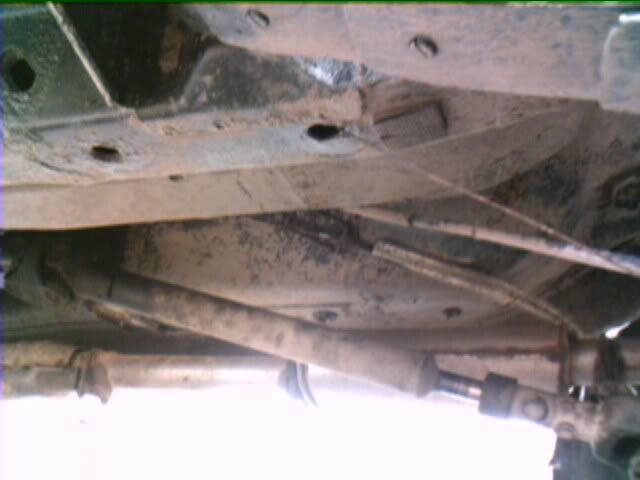

Are you doing a hack n' tap or the HD SYE (advance adapter style)? If you want, I could measure the distance from the TC rear housing to the end of the yoke so you could see how much you would be shortening your output shaft. I have the PORC SYE with a front DS in the rear (advance adapter style). Here's a pic of mine with about 6" of lift in the rear. There's about three inches of compression left on it. I can measure if for sure when I get home from work. This is actually my front ds before I picked up another one. You can kinda see there are three shades of color on it. The darkest part was from stock height, the middle color was after my lift when it was on the front, and the shiney part was from putting in the rear.
