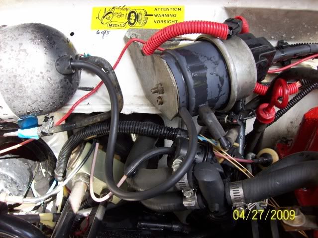

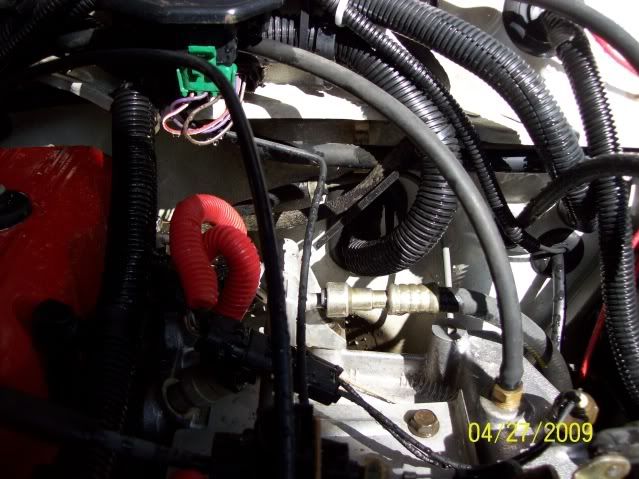

There are two vacuum lines coming out of the firewall just next to the heater hoses...one is black and goes to the vacuum reservoir behind the pass front bumper. The other line coming out of the firewall is pink(ish) and should attach to the heater control valve.
I'm not exactly sure which way it goes (either vacuum applied opens the valve...or lack of vacuum opens the valve) but those two lines are responsible for ALL the vacuum for the HVAC system. Starting at the SOURCE vacuum that comes from the intake manifold, to the reservoir (behind the bumper) through the black line, out the pink line (as I understand it).
The line coming off the manifold (lower right) crosses over/behind the engine to provide vacuum to the reservoir.
The pink line goes to the heater control valve. Yours looks different (Mine is a 90 Renix but I relocated the vacuum reservoir and I'm using a 91+ heater valve because I converted to an open system) but it's the same pink hose. If you have a broken or missing/disconnected line anywhere along this line your either your blend doors won't operate properly or your valve won't open...or both.
These lines have nothing to do with the emissions system or how the truck runs, UNLESS the leak is at the manifold or from the manifold to the reservoir. then it will present as a high idle condition (in my experience)
I have since deleted the heater valve and run the hoses strait from the thermostat to the water pump, just like a 97+. It works fine and does not interfere with the A/C. It also allowed me to clean this whole area up...no more hoses running everywhere...I also deleted all the front axle vacuum lines and locked over the axle so further eliminating more vac lines.
