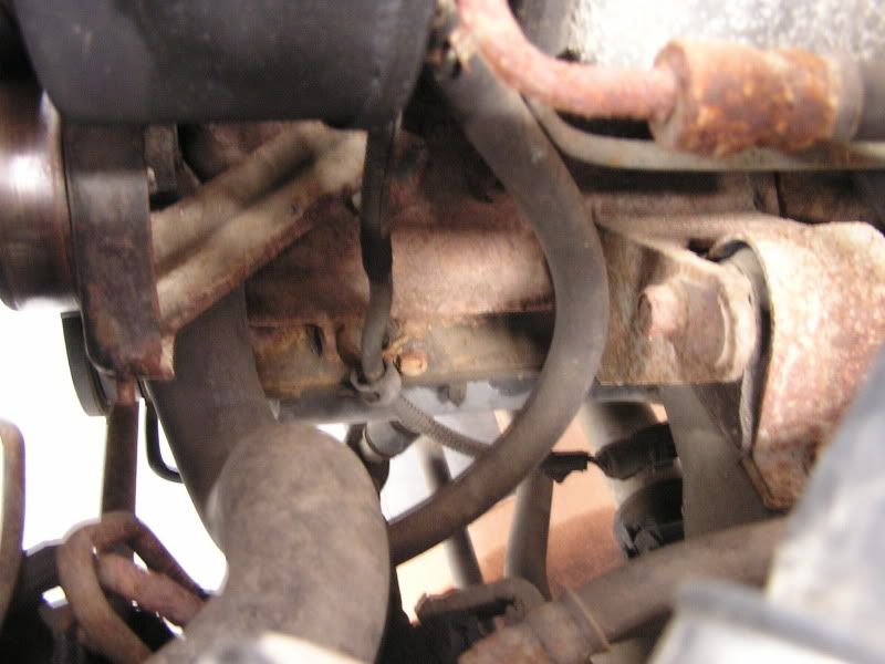

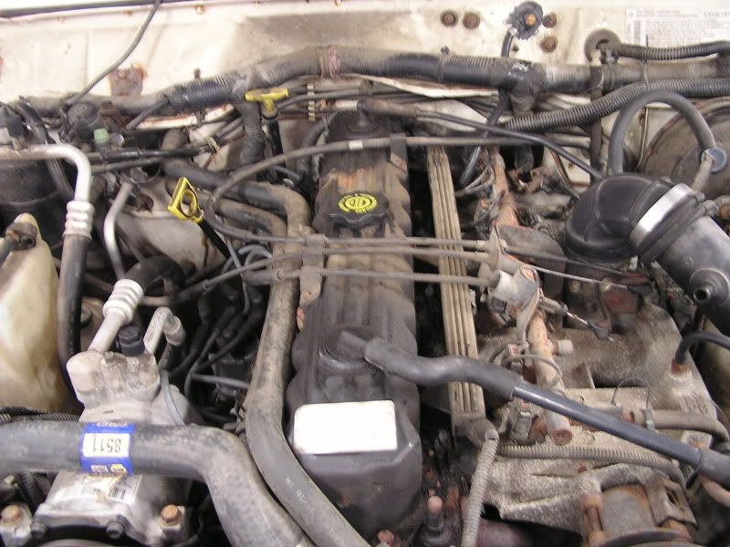

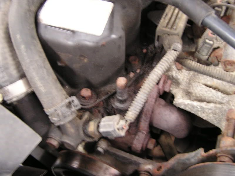

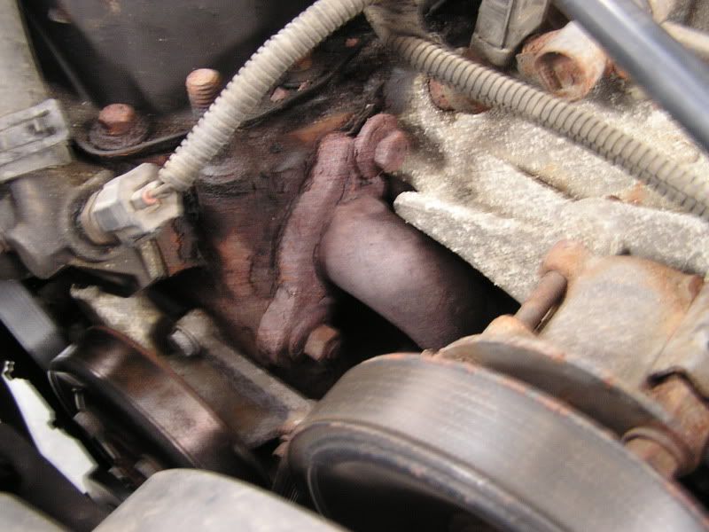

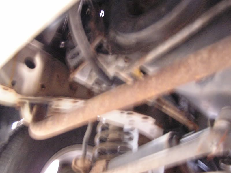

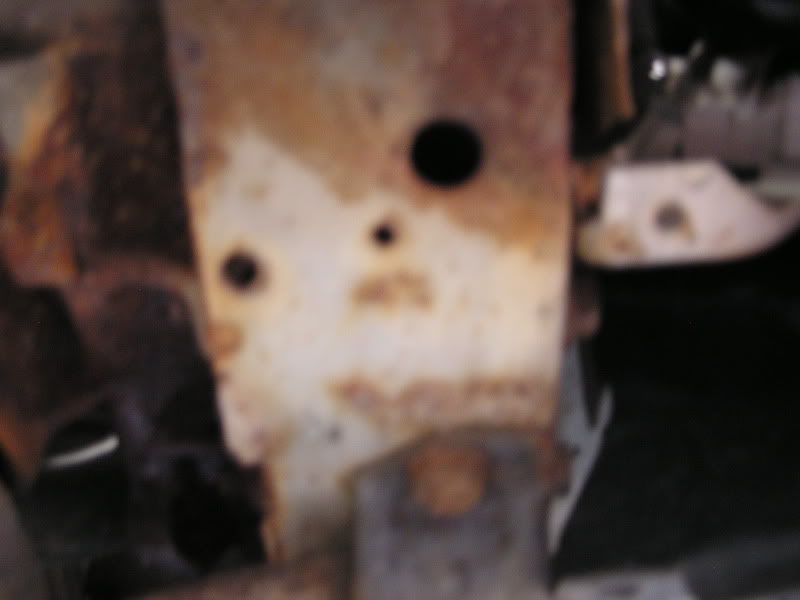

Here are some pictures:

body - POR-15 (paint-over-rust) is great stuff, sand a bit to remove loose bits and coat it good with this paint.
engine - sand and use a high-temp enamel. Skip the exhaust header unless you plan on taking it off and baking it
