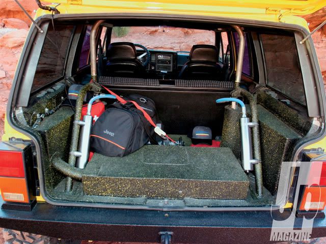

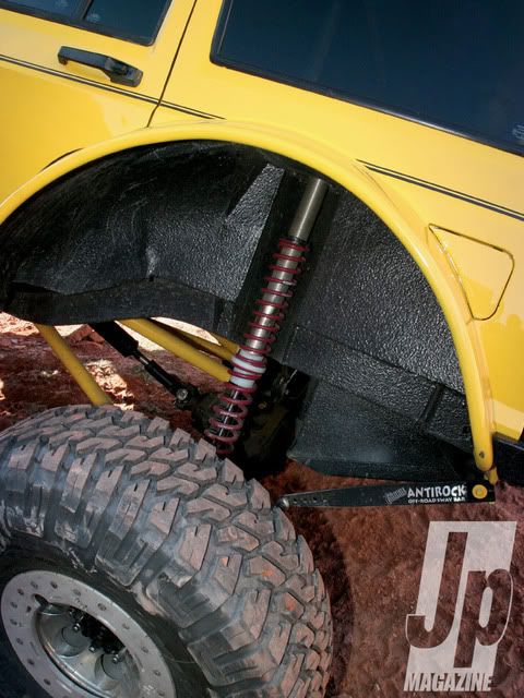

Do this and then Raise your upper mounts into the cargo area, if looks aren't an issue It'll let you run MUCH longer shocks to give you more droop...

The pics are great guys. That yellow monster is Waaaayyy overkill for me at this point, because I live in FL the land of eternal flatness..
