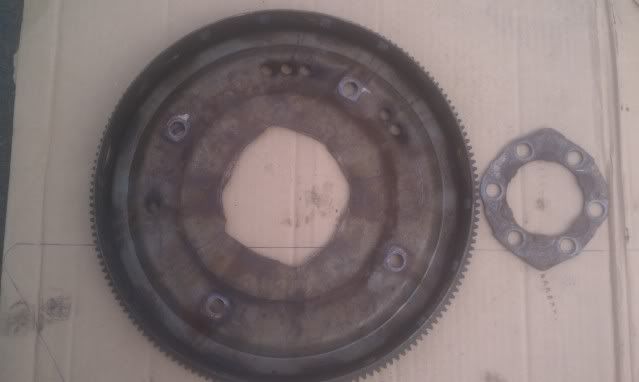

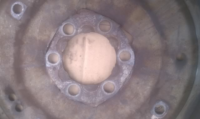

I know of 3 guys in my local club who had cracked flexplates including myself. If you remove the 3 or 4 bolts holding the inspection cover off you can see the flexplate fairly well then. You may need to clean it really well with brake cleaner to see them unless they are really bad. Usually cracks are caused by loose trans bell housing to engine or torque converter to flexplate bolts. This causes the flexplate to twist instead of rotate. Here's a couple pics for reference.
This was mine, it make a loud knocking noise at idle that went away above 1500rpm. The marker is to outline all the different cracks.
This what happens if you ignore it way too long.

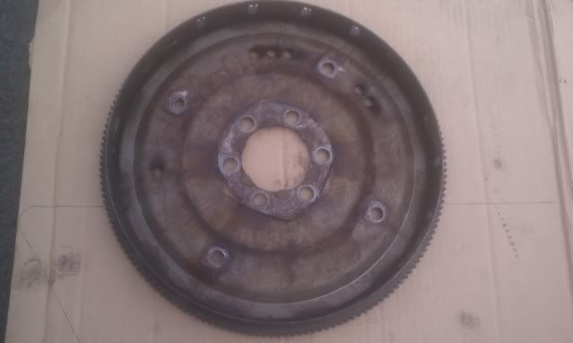

Here's the other one from my friend Steves XJ
