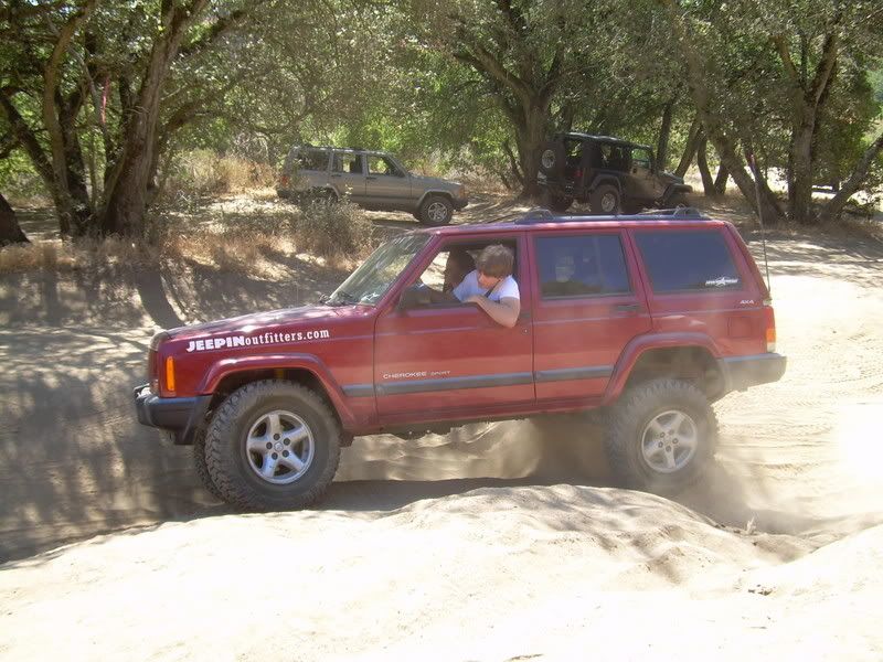

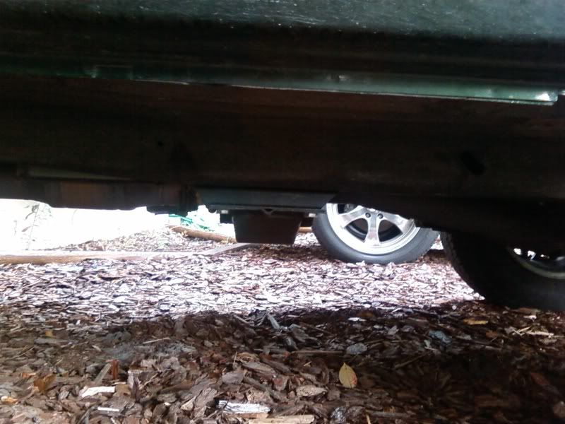

First off, I want to thank everyone that provided advice and answers when I was trying to do this.
It's a set of TJ/XJ front spacers (1 7/8") and a S-10 main AAL from a '93 2wd. Shocks are the originals. I also added a 1" x 1" x 0.125" 45* cut TC drop to fix some minor 25-30 mph vibes.
So, my technical question is: since this was such an easy job, how much would it cost to build my own ~4" lift systems (to clear a 31" or 32" tire)? Ignoring the SYE/DS and shocks, because they will be the same for both, and assuming I'm doing all the work. Can I save money over the RE3.5" SF, or is this is solid enough kit that I would benefit from just buying it, and upgrading later on as I go?
Thanks again for all the help!

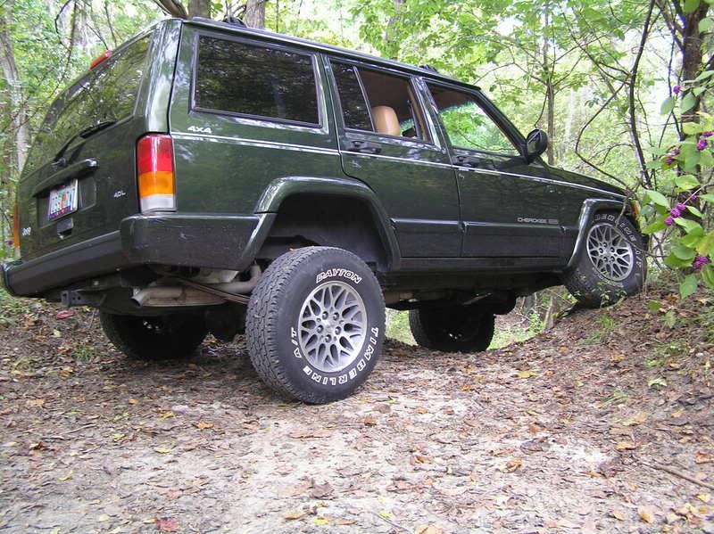

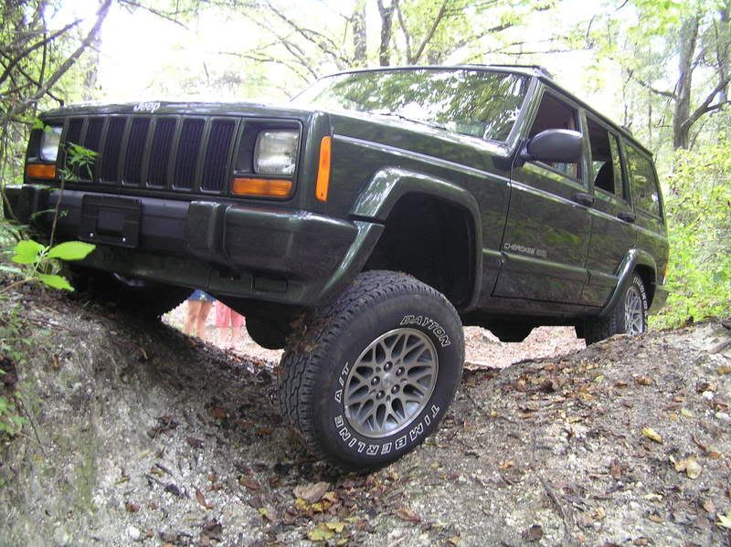

kyle - do you have any pics with your leafs flexed out? im curious how the 3.5" RE leafs compare to the OME 3" leafs...
thanks again!
lost honda pro is offline   Reply With Quote
Old 10-03-2007, 02:06 PM   #15
XJK
The Guru of Nothing
XJK's Avatar
Join Date: Jan 2007
Location: Santa Rosa, Ca
Posts: 6,708
im not sure exactly what you want but ill post up a couple, tell me if you want something different.
-Kyle
