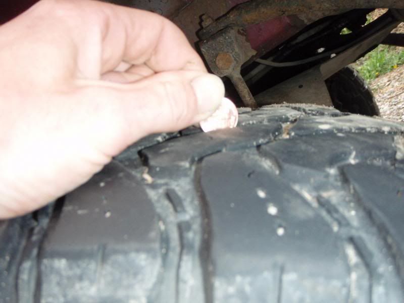

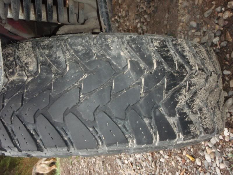

heres some pics...the first one is of the passenger side tire "flatspot" its about a foot long and then the tread becomes "normal"

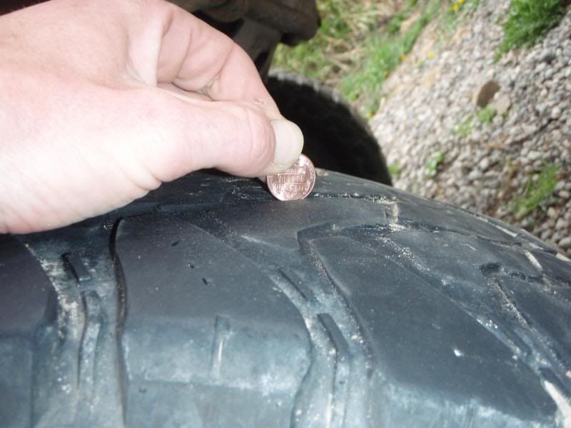

normal tread depth just above flatspot

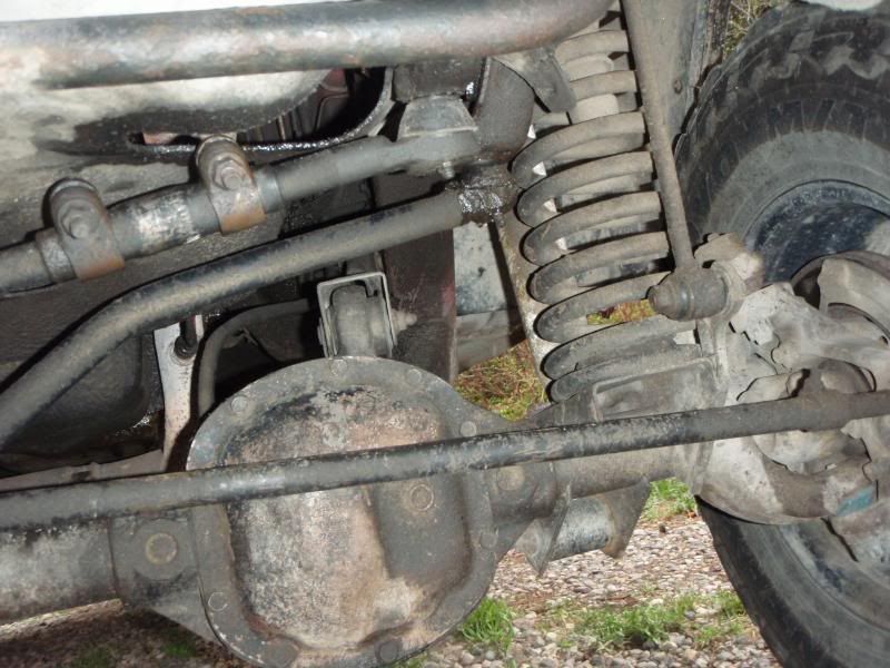

passenger side

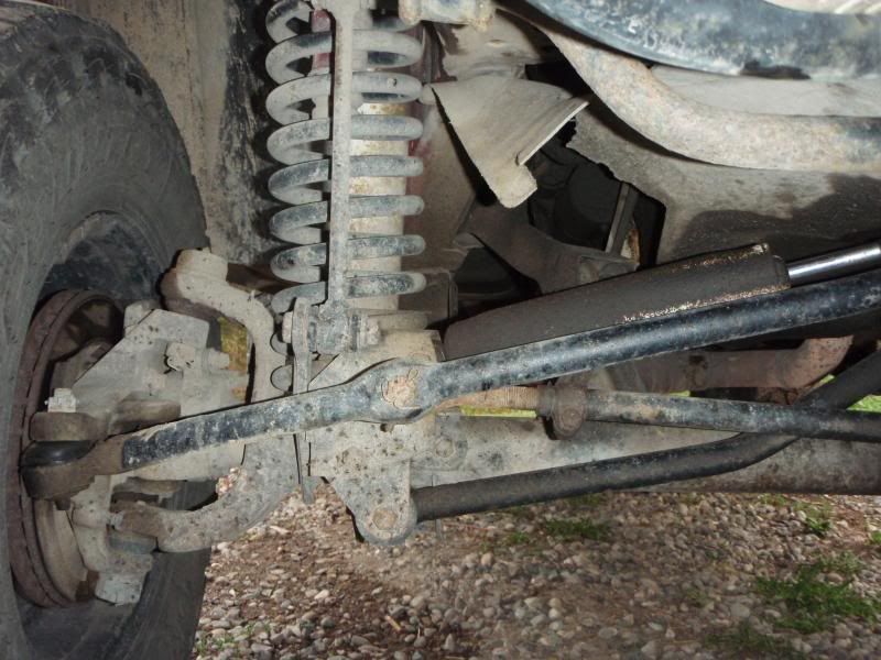

drivers side

broken belt most likely.

It could be a manufacturing variance, an out of round tire casing, lack of routine tire balance/rotation, or as suggested maybe a broken tread belt. The odd wear and the thud noise are probably related.
