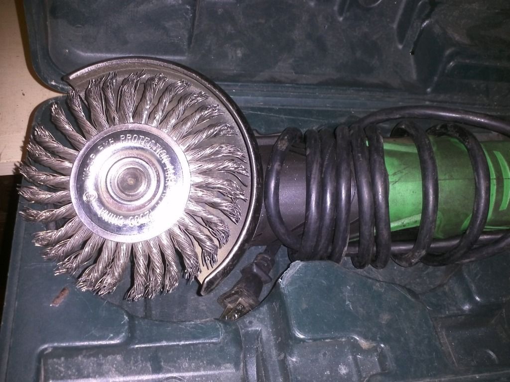

Originally Posted by AZ Jeff View Post
Clean and degrease area THOROUGHLY with brake cleaner and toothbrush. Allow to dry. Apply thin layer of HIGH TEMPERATURE RTV to the area, working it into the groove of the joint between the head and the block, and allow to cure. Leak gone.
Toothbrush...Check
Mucho grease lightning and brake cleaner later...
Clean, I think
Decisions Decisions...The two on the left are out
First some high temp
Then 2 liberal applications of ultimate. 100 miles later, keeping my fingers crossed that this did it for now...
