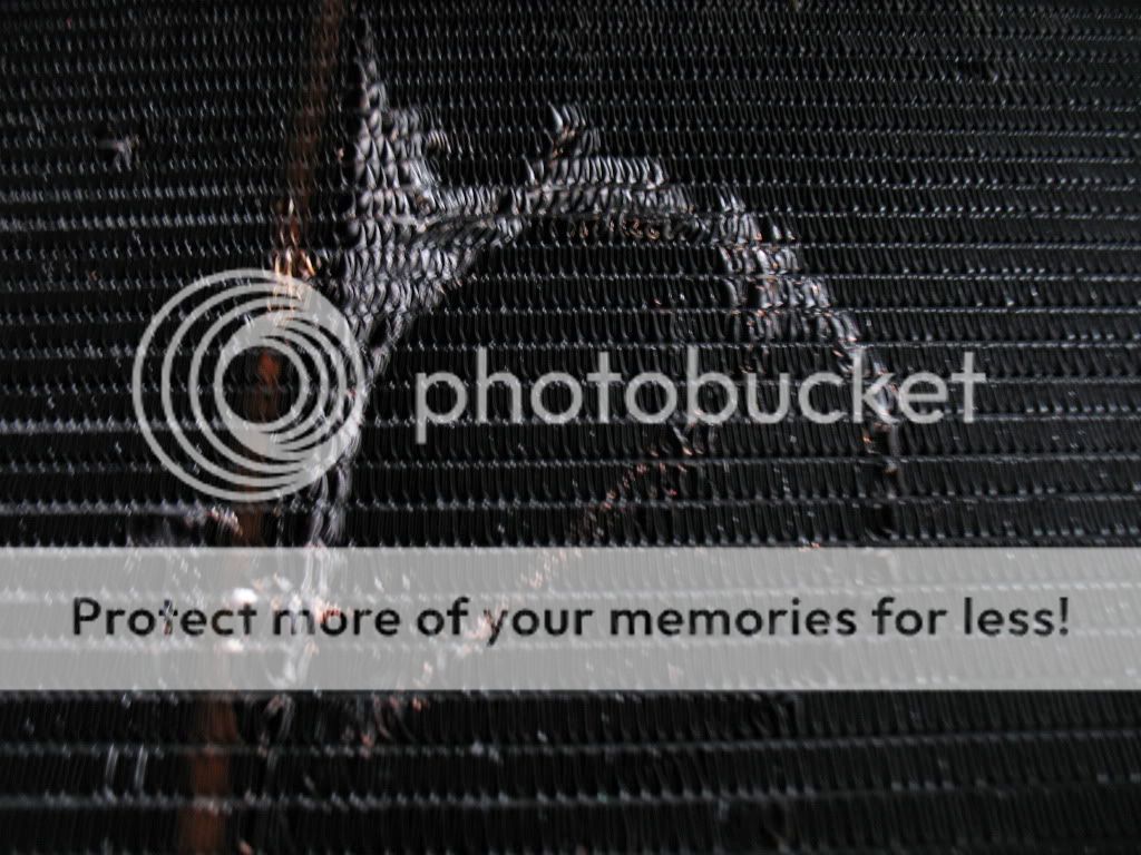

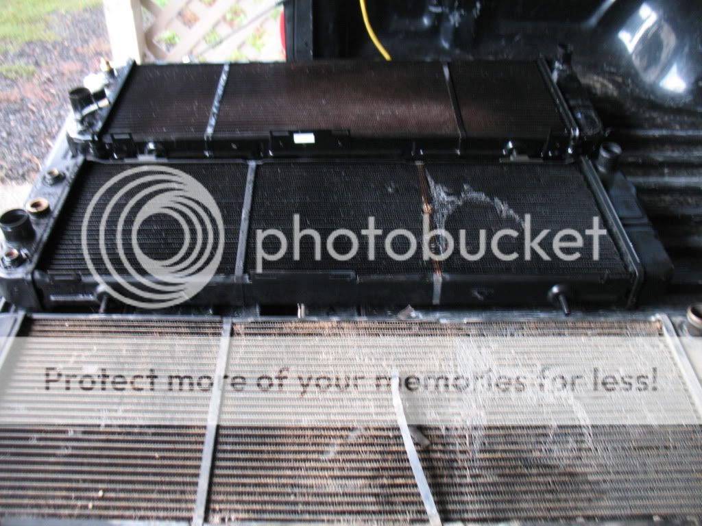

here are the pics of the first two radiators and hopefully the final radiator if i get it all fixed and nothing else goes wrong. i was very impressed with napa btw for getting bolth of the new radiators shipped in one day and for much cheaper then anywhere else, bolth new ones are all metal, 3 row radiators for around 120$ would deffinatly recomend them, the newest radiator since proliance went bankrupt is "CSF" brand part number "2572" for anyone thinking of getting a new one
