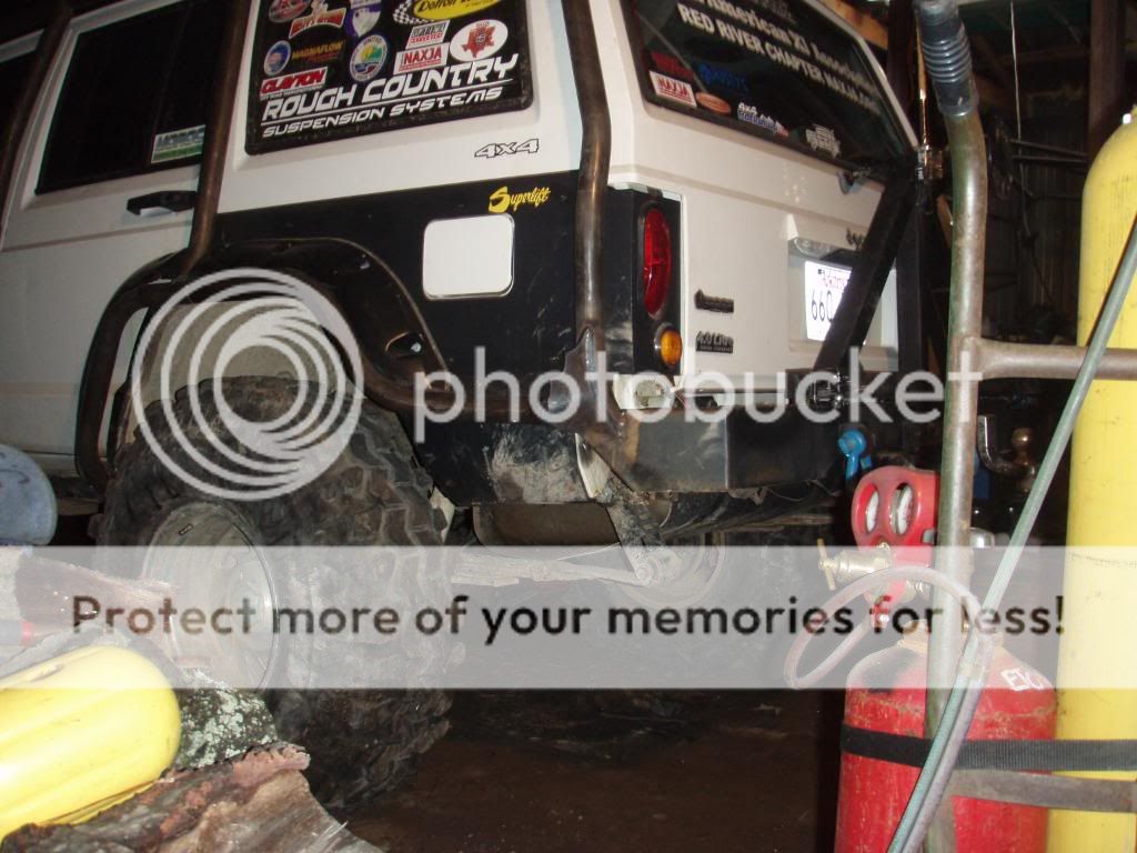

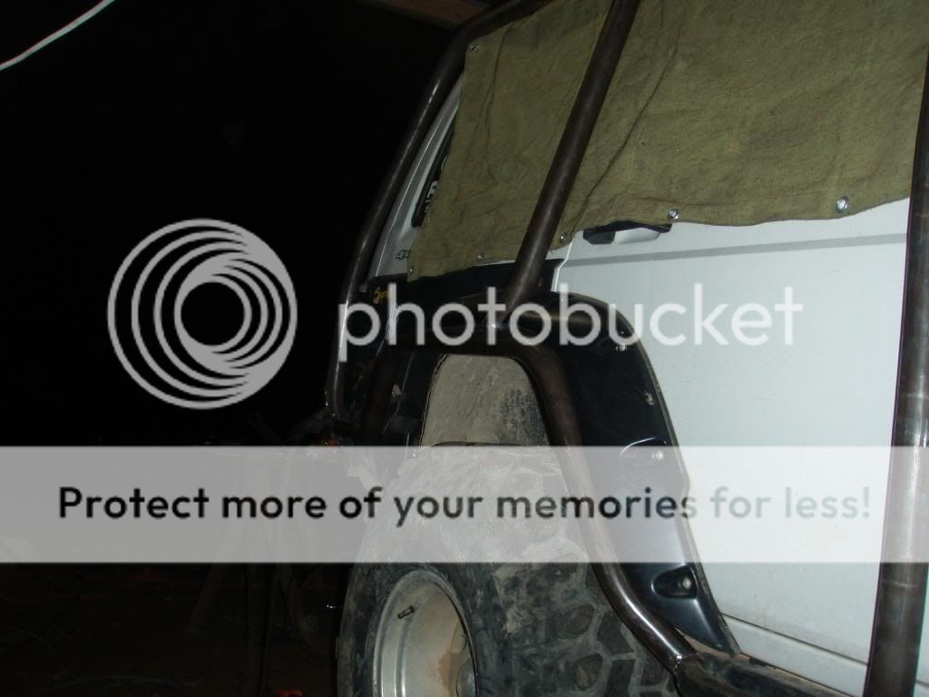

Heath just sent me a few updates.

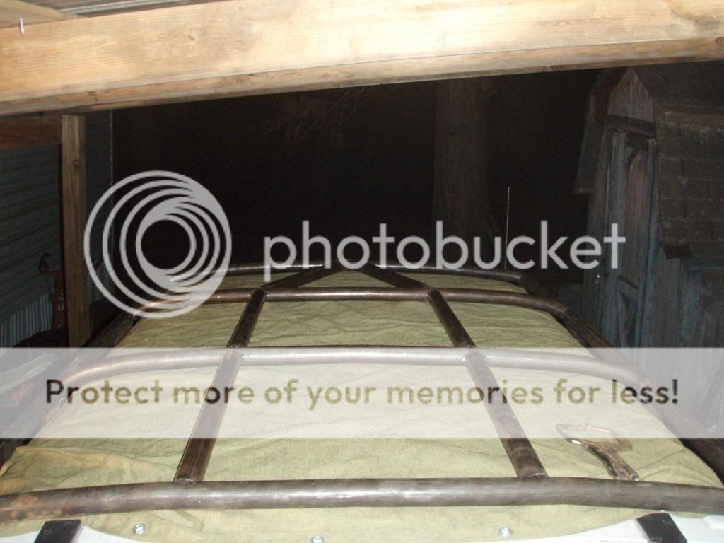

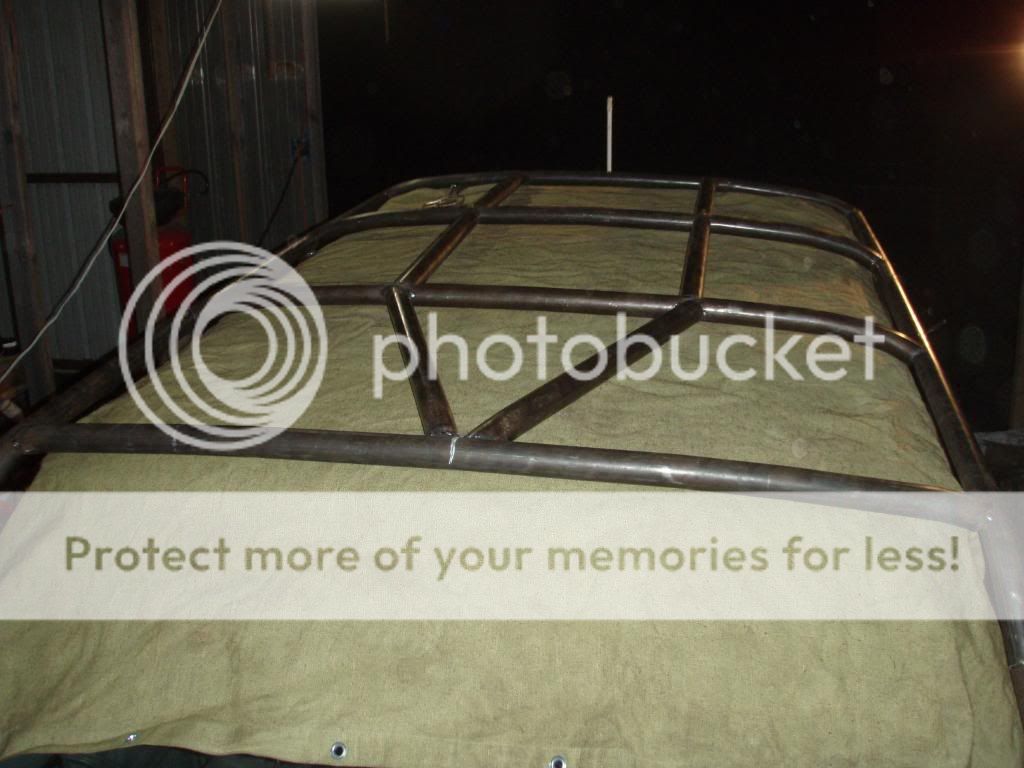

post #21 of 29 Old 12-17-2009, 09:15 AM Thread Starter
X2elite
Join Date: Apr 2007
Location: Texarkana AR/TX
Posts: 183
Top!
Other side......

post #22 of 29 Old 12-17-2009, 09:21 AM
Starboard M
Join Date: Jun 2005
Location: CO
Posts: 871
Interesting roof bars. Any reason you didnt triangulate anything?
Originally Posted by NoVaHunter View Post
Honestly, its dicks like you that make unnecessary comments via the internet that have no impact what so ever.
Starboard M is offline
post #23 of 29 Old 12-17-2009, 09:33 AM Thread Starter
X2elite
Join Date: Apr 2007
Posts: 183
It is a hybrid cage with triangulation on the interior, but with the small squares laid out on the roof there was no real need for triangulation. Any pressure put on the roof will likely cause the cage to buckle towards the bottom of the jeep, or accross the jeep. There really isn't much threat of one of those little squares buckling in on itself. Make sense? He could have done it that way, because I guess there is always that chance, but from a safety standpoint I am not worried about it. Also I just think it looks better that way.
