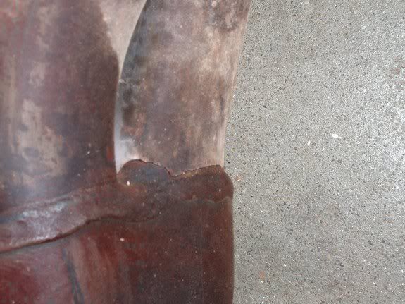

This is where they typically crack. I would visually check to see that this is indeed the problem before replacing. The APN header is a good replacement and is priced right. Make sure your engine mounts are good and it should last a long time. The reason they crack is because they are unable to flex when the engine moves during acceleration.
