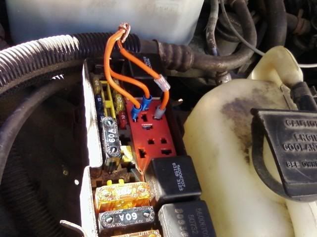

I got Dave's shop manual after church & made some jumpers.... I was going to see if I could force it to kick in...
Figured I would try it again first, turned to to "run" position, all my dash lights & buzzers come on.... Turn to "start" and everything goes dead.
As I was going from "start" back to "run", the fuel pump cycled...Tried again, same thing....
Was going to try again, but held the key in the "start" position for about 10 seconds.... all of a sudden the starter kicked in & the Jeep started right up.

I think it is a wire connection between the switch & relay box... Here's an update - got out to my Jeep to go home last night, and it would not start AT ALL - Period. With the help of a friend, a little wire and some head scratchin, we got her running.
I just need to plug & unplug wires to start (or stop) the Jeep. At least until I run a couple of wires and a toggle switch...
