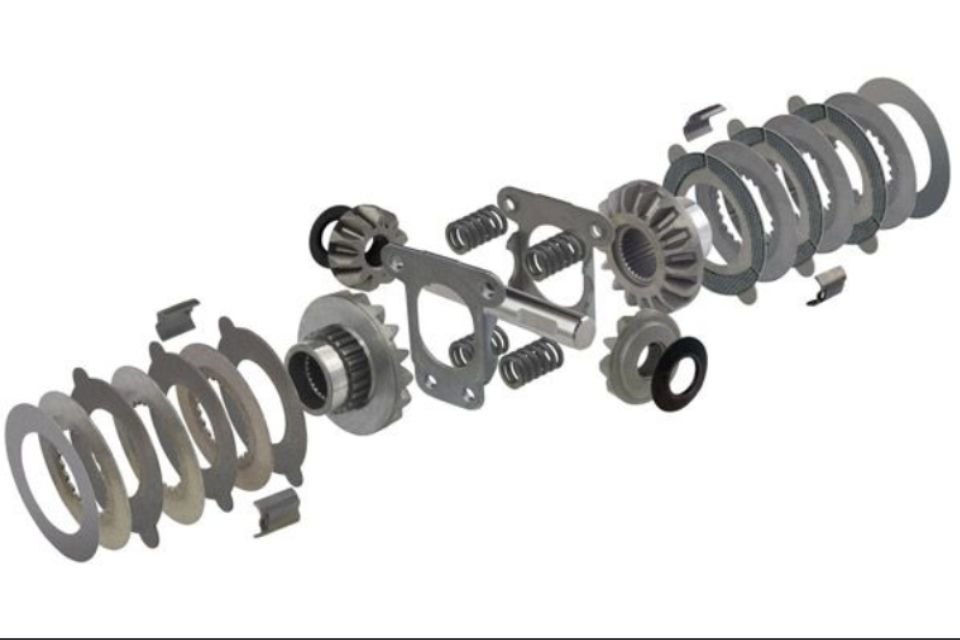

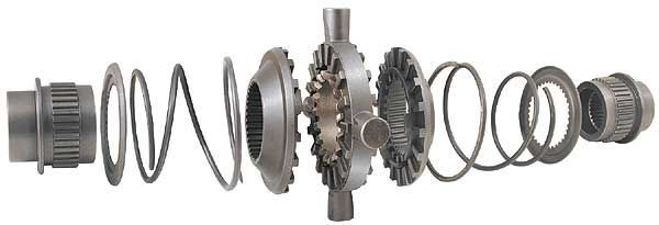

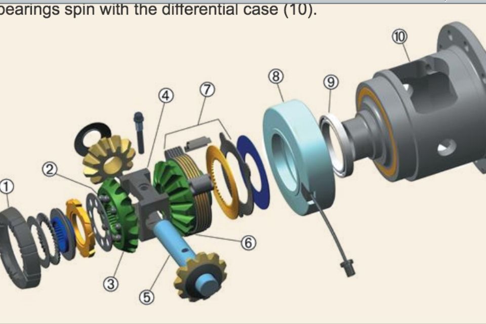

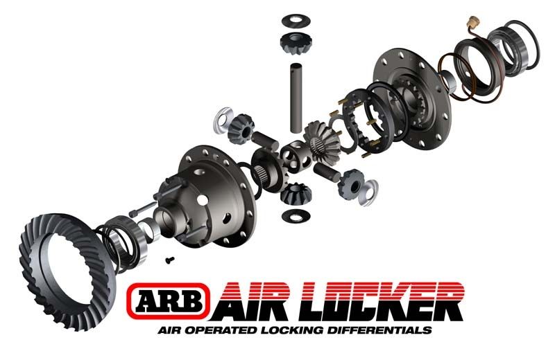

Just for future reference to all who are inquiring about a ECTED and reading this thread.
ECTED clutch pack exploded view
ARB selectable locker exploded view

Detroit non select automatic locker exploded view

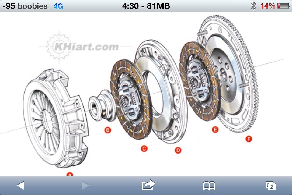

And for no reason at all here is a high performance twin plate clutch (for transmission engagement).
I'm bored at my father in laws house
