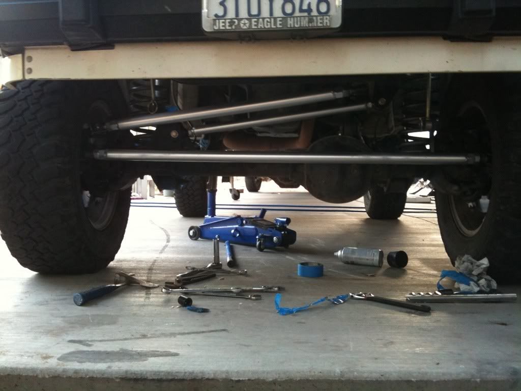

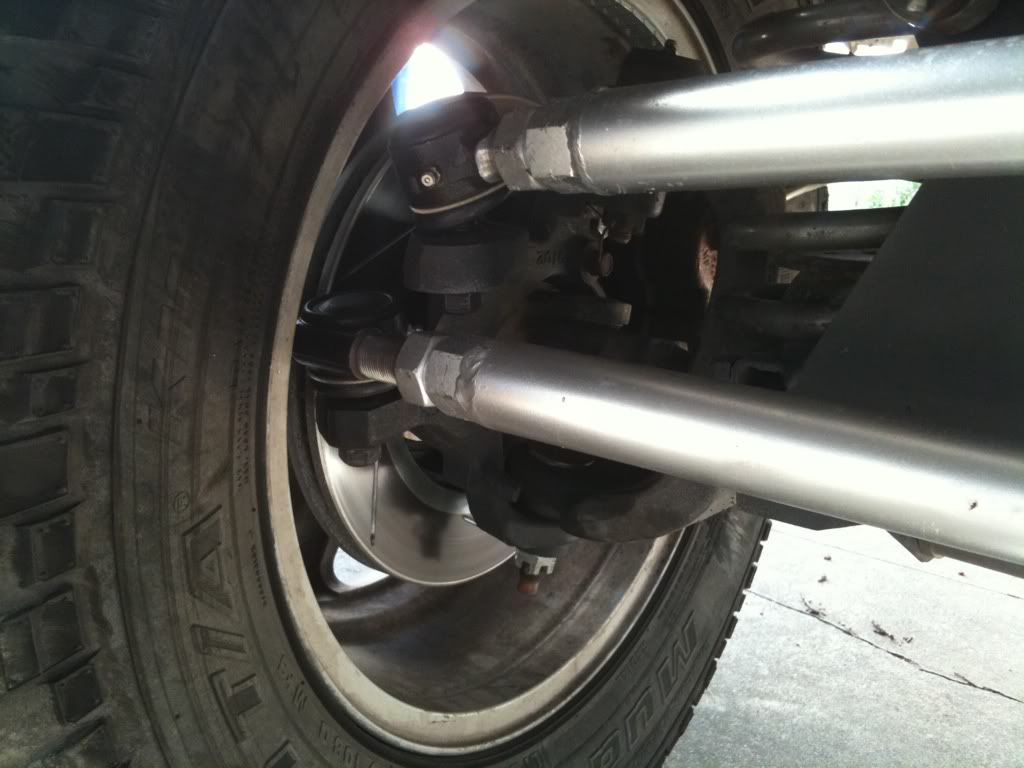

I put the WJ knuckles on. Get to ditch the retarded inverted Y for a true crossover, plus get twin piston caliper upgrade. I also opted for the over the knuckle steering and the over the axle trackbar. All 1.5" DOM or 1.25" chromoly and tig welded.

His profile says he has 17" moabs... not sure if thats what he's actually running or not, but based on the clearance to the inside of the rim around that offset TRE, I'd guess he's running at least 16s (I run 16s on mine and that clearance looks similar). I think most people who get away with 15s are running Teves calipers, or very little backspacing.

I went with 17" moabs off an 08 rubicon. But 16" steelies fit with some ingenuity. I used the JKS over axle bracket so i needed offset TREs to clear the bracket. These offset TREs needed more clearance off the knuckle then 16" aluminum would allow. Plus i had 17" moabs before i even had the WJ swap in swirling around in ma noggin.
But seriously, it is the best suspension and braking upgrade for a lifted XJ. It far exceeded my expectations.
