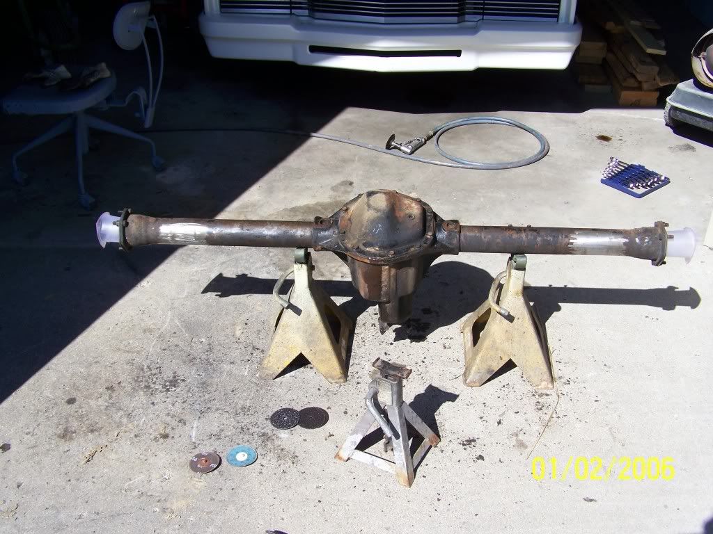

Stripped, brackets cut off, and sealed up ready to go to the sand blasters tomorrow.

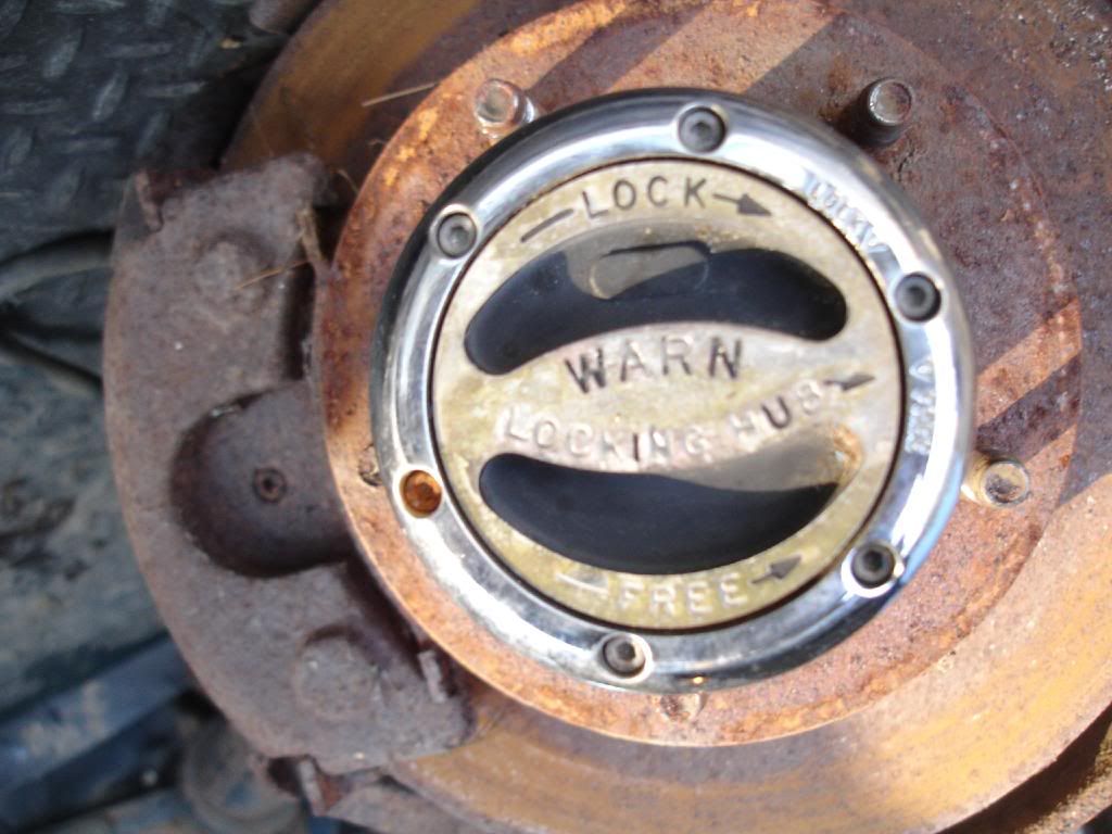

Latest update:
78 Bronco HP44, 4.10s, LSD, and Warn lock out hubs, for $100, and thats the MJ 44 rear in primmer next to it.
