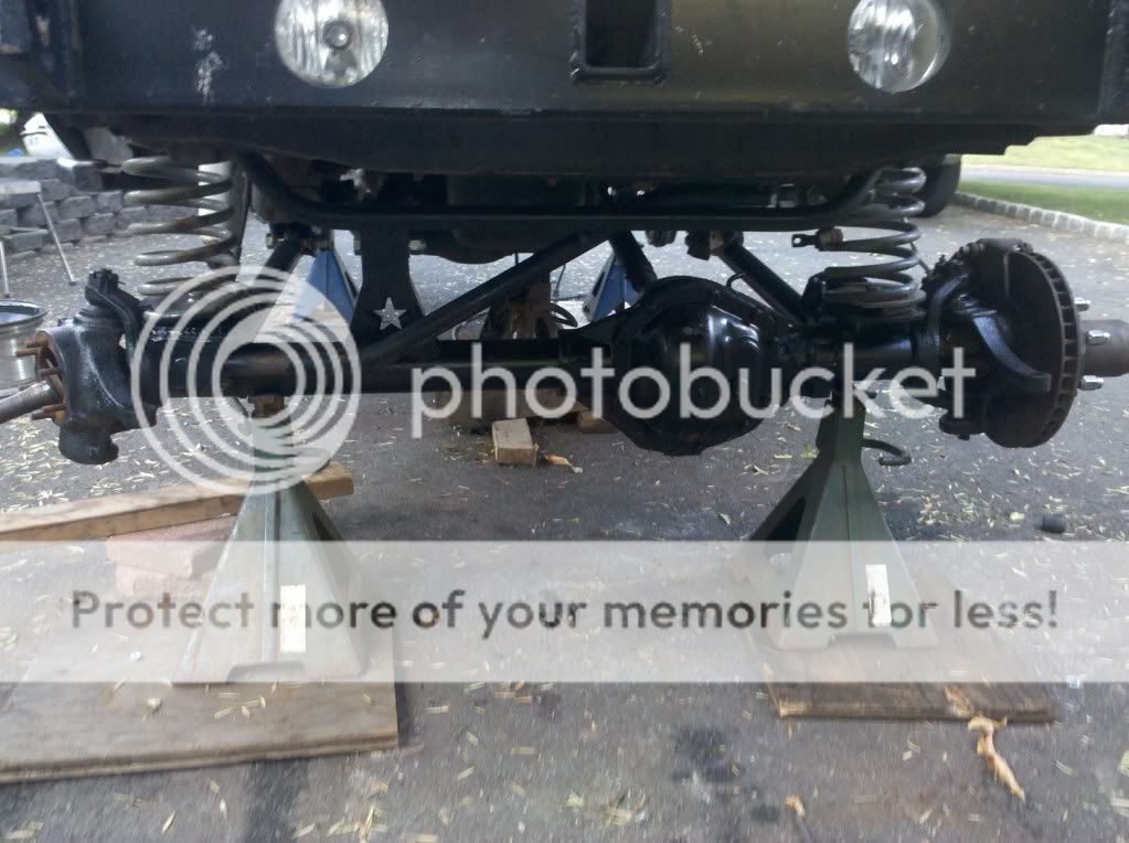

Originally Posted by 2doorxj View Post
Just for future reference since it's done at this point - big pretty cutouts in load bearing structures are rarely a good idea, especially cutouts with pointy ends like that. The tips of that star, in particular the two that ended up right next to the welds, are big stress concentrations (multipliers). The sharper the point, the higher the stress concentration.
Nice work though.
Nice work though.
As a structural engineer I agree with you, but he's using that piece with the star just as a brace between the two vertical side members that transfer the force. He'll be fine.
For this application I agree it probably is fine, it's just a peeve of mine. If the tower ever does fatigue out though I'd bet money on the cracks starting right around those two star points.
Thanks for the heads up, ill keep an eye on it.
