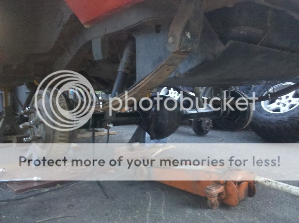

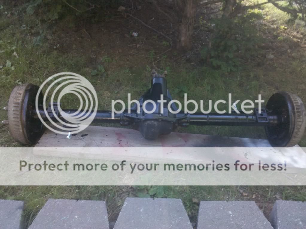

Painted the rear dif with rustoleum brush on satin black, i love this stuff!
Bolted the rear in, i still need to put my brake lines on it.
I got the pinion angle near perfect
I also got the front 44 coil buckets tacked on
Still waiting on DOM from ballistic fab, i regret not getting it locally.

apart from the rims, how did you remove the grime from the axles to prep them for paint?
fedx95 is offline
post #54 of 379 Old 07-10-2011, 11:02 AM Thread Starter
2doorxj
2doorxj's Avatar
Location: NNJ
Posts: 2,920
I used simple green concentrate, i sprayed it all over the axle, and i let it sit, then i used a pressure washer to take all the crap off, it works very well.

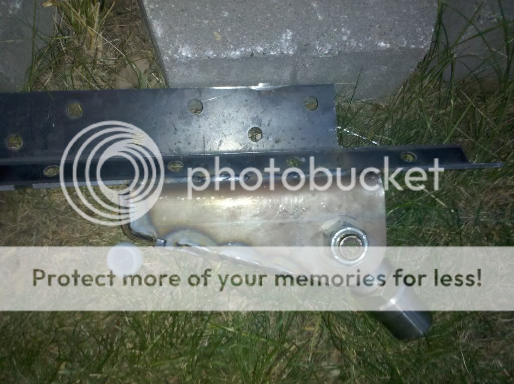

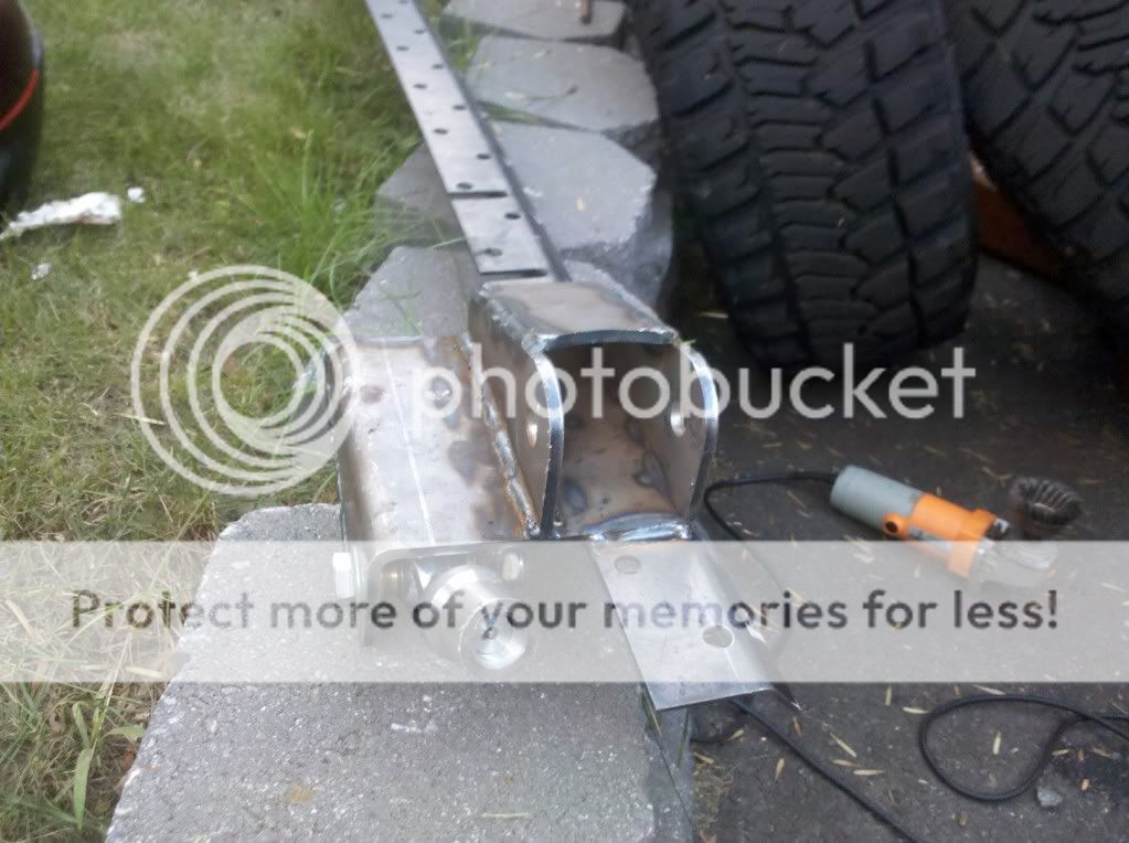

Cleaned both frame rails, first i did it with a twisted wire wheel, then a flap wheel:
Got the drivers side mount welded up:
And passenger:
Boy, did those cleaning those frame rails suck!
I also picked up some u joint u bolts for the rear, and a 760x joint for the wagoneer, i need to get one more joint still. I plan on running full circle clips.

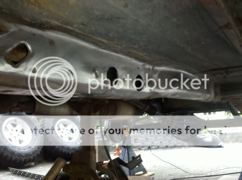

Got both frame stiffeners partially welded up today.
I drilled two 7/8s hole on both side of the frame where the old crossmember stud/nut used to go. That was NOT fun, i broke one of my expensive step drill bits, and a couple other drill bits. I was using my dads super heavy duty milwaukee drill, that damn thing almost broke both my wrists multiple times.
I then welded in 1/2 nuts inside the stiffener on both sides.
Getting the nuts lined up with the holes i drilled in the frame was not an easy task, but after some "convincing" i got both stiffeners lined up great.
Heres the passenger side link mount
Im going to weld the upper link mount to the inside of the frame rail for added support. I might even run a gusset that goes from the rear of the link mount to the inside of the frame rail for even more support.
Ill get better/more pics of everything after its all burned in tommorow.
