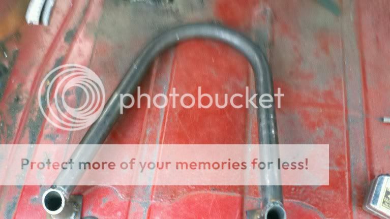

Made some progress today:

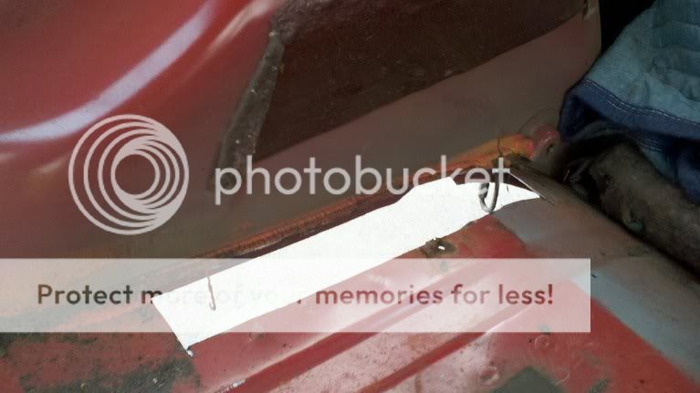

Hole cut in floor:
Hoop cut to length and notched/welded:

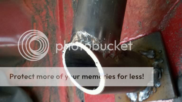

Welding with a friend of mine's miller 110v........i miss my 220 , waiting on a new hose in the mail for it:
Right now the hoop is welded to some 3/16 plate and that is welded to the frame rail.
Im picking up some 3x3 angle iron to plate the rear section of the frame.
Tommorow im doing the same to the otherside, and running a bar across connecting both hoops at the top. Im also going to take a ride to a local steel supplier to see of they have the angle iron.

im thinking your going to have to widen that hole some for your rear shocks. you'd be surprise how much the shocks will move when flexing.
A little massaging with a BFH will do the trick.

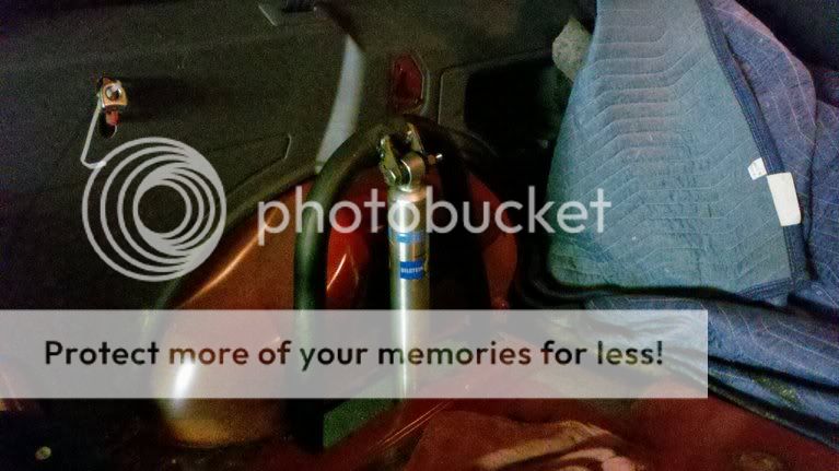

looks good. are your shocks straight up and down or do they have a slight curve back? i cant quite tell from the pic
also are you going to run into any issues with the rear seat latching?

For reinforcing the brackets, possible gusset from the bracket to the floor?

You pretty confident with the weld on that side (the frame plate piece)? Looks a little cold.
No issue, i still apreciate the response.
Its as hot as my buddies welder goes, like i said in that post, i miss my 220
I do think itll hold though
Seat will clear, but just bareley, and the shocks have a very slight curve back
The floor is super thin and weak, i wouldnt want to weld to it for support
