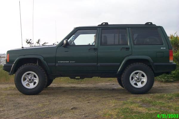

My lift plus tires total'd $828.
$317 for the lift kit, Its a Rustys 3" that came with Springs, Long AAL's, Shocks, and a rear brakeline extension bracket, the Lift cost $245, Plus $60 shipping, Plus I bought a $13 transfer case drop that I ended up not using. Oh, and figure on renting spring compressors, should only be $10.
$511 for four 31x10.5x15's mounted and balanced
I am VERY happy with the result!

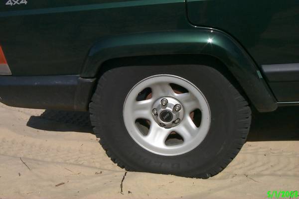

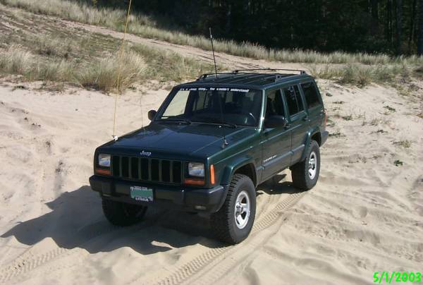

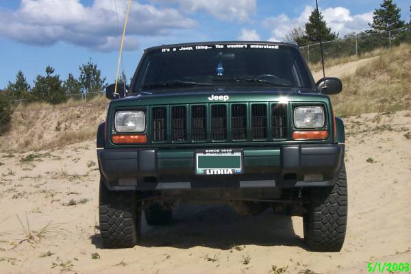

here ya go.
Here is a pic of max flex in the rear that I took today with my 31's...
Yes its touching the flare, and it made some ugly sounds when I backed out after this pic.... (rear swarbar has been removed)
Just butting in with an observation -
This pic is a good example for tire fitment. Every time someone asks about fitting a 31" tire (and they will always include "without trimming"), I always say at least 3" of lift and keep the 31's on stock wheels. If they were sticking out any further you'd start tearing stuff off.
Nice flex and nice looking jeep Dacaur.
