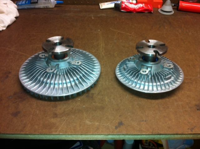

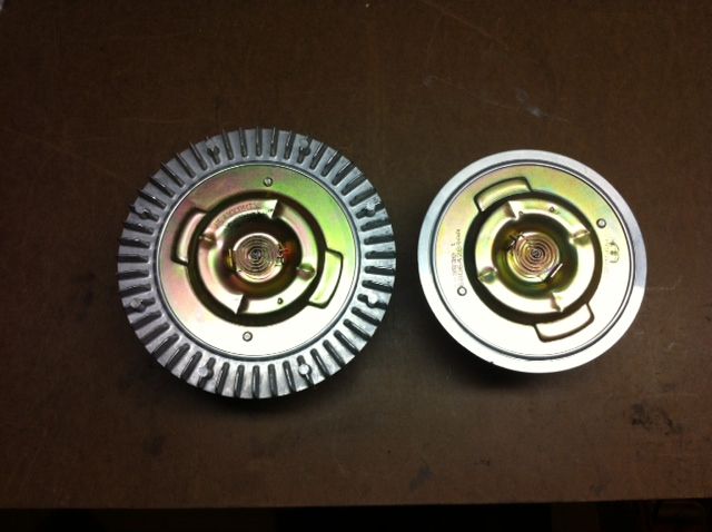

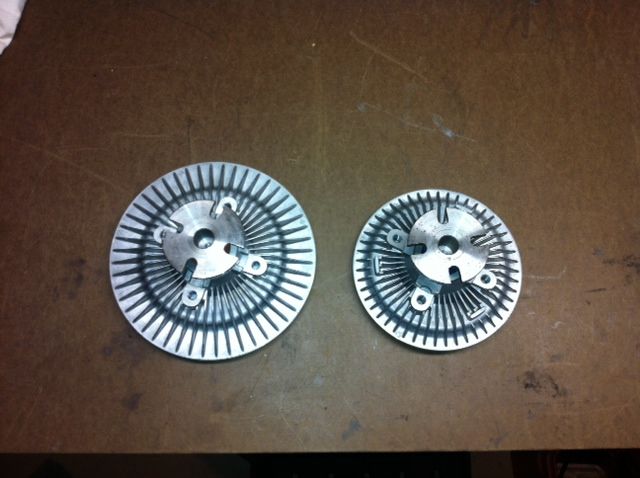

The wrong one from Autozone is the SAME as the Napa ZJ clutch. I compared them. And the ZJ clutch from NAPA is larger than the stock one.
In the pics below, NAPA # 272310 (ZJ clutch) on left and Mopar part# 52079625AB (stock 4.0 XJ clutch) on right:
The ZJ max cool clutch is much thicker than the ones shown above and won't even fit an XJ with a stock radiator.
-Josh

As jeepkids pictures show, p/n#272310 from NAPA is considerably larger. I run it along with a CSF 3 core rad and I'm not worried about interference because I'm running Ironman4x4 motor mounts with poly bushings in them. There is very, very little movement of the motor inside the engine bay, and absolutely no forward motion. What are you replacing your motor mounts with? OEM stuff? If so I wouldn't run the ZJ fan clutch. If you go with Brown Dog or Ironman4x4 or something similar you should be fine.

Its not the wrong part, its a commonly used fan clutch from a ZJ that locks up tighter than the stock fan clutch. Its quite commonly recommended on here and other forums for moving more air while being louder. It also happens to be larger, and along with the 3 core CSF rad which is slightly thicker than stock, leads to less than factory clearance between the fan clutch and rad.

I'm glad to see that side by side comparison, and the motor mount recommendation. I was JUST about to find a ZJ fan clutch, but will hold off til I get some better mounts set up.
