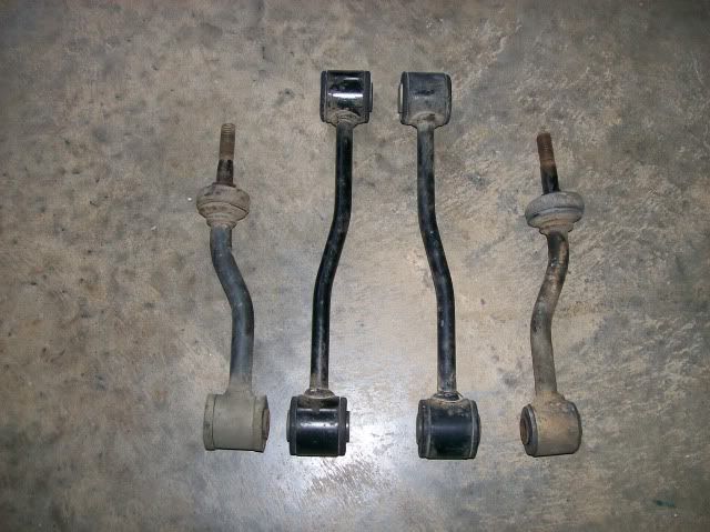

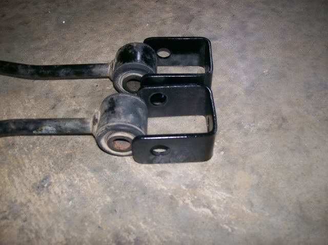

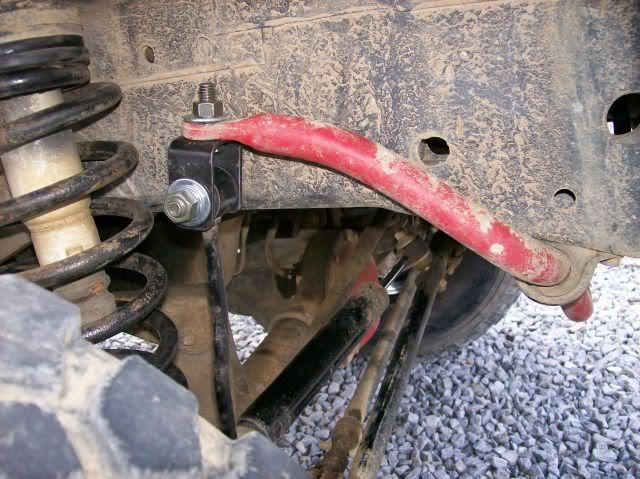

Just wanted to share my cheap swaybar links for my XJ. I recently lifted my WJ and the lift came with longer rear swaybar endlinks. After removing the stock rears a lightbulb went off in my head. I was using the stock links on my XJ with a bit over 3" of lift and every once in a while they would contact my coil springs. I decided to modify the WJ links to work on the XJ since I don't disconnect my swaybar much anymore. Here are the two side by side. The rear links from the WJ are about 3" longer, but they mount different than the stock XJ links so I fabbed up some mounts from 1 1/4" flat stock I had laying around. I drilled the holes in the sides to 1/2" and the hole for the top is 7/16" I then installed them with 1/2"x2.5" bolts for the upper bushings and bracket, and 7/16" bolts for the top mount. They put the swaybar back up to where it should sit and no more hitting the coil springs. I should have removed the tire for a better picture, but I am lazy

did you just bend the stock in a vice?
great idea BTW
Yes. I bent it in a vice and cut it to length with an angle grinder.

Does everything ride right with the sway bar angled that high? Mine is about that high maybe a little higher. I have really bad death wobble and I cant figure out why, I've been fighting this ever since I added 3'' zone lift about 3 months ago. I have an adj. trac bar, I got an alignment (that lasted 24 hrs). I've tried two different sets of wheels and tires. I dont have any play that I can tell in any of the linkage or any of that. the only thing that looks off to me is the angle of the sway bar (maybe links to long?) and it has some side to side play. Any thoughts?
