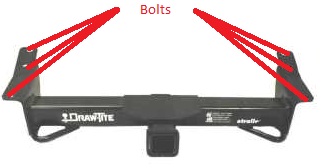

I have a front mounted receiver on my XJ. I don't currently have the money for a winch, but have seen it done before. You would have to get a winch plate like this. The hitch is rated for a 9,000lb line pull, and was super easy to install.

^ 2 bolts per side????

there are 3 per side. the 2 from the sway bar, and one that you drill for a half in bolt.
