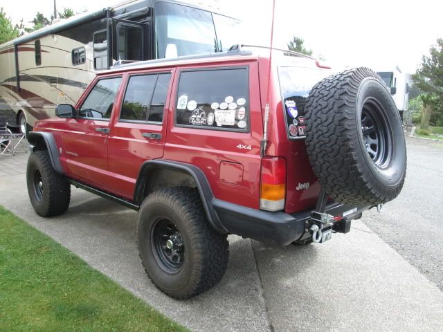

When I moved to 31s I had to mount my spare on a swing out tail gate. The other option is roof mount. You can use a smaller spare in 2WD but I would not do that in 4WD except for a short distance in an emergency.

With our '98 running 31s we carried the factory spare mounted in side. With our current 33s we carrry a 33 spare on tailgate mount(Detours USA). Would NOT mount on roof as it will raise your center of gravity, etc.

You could build a trunk and bust out your back window and go with a truck mount..... gets a little drafty in the winter... buts its not so bad unless your a pu$$^
