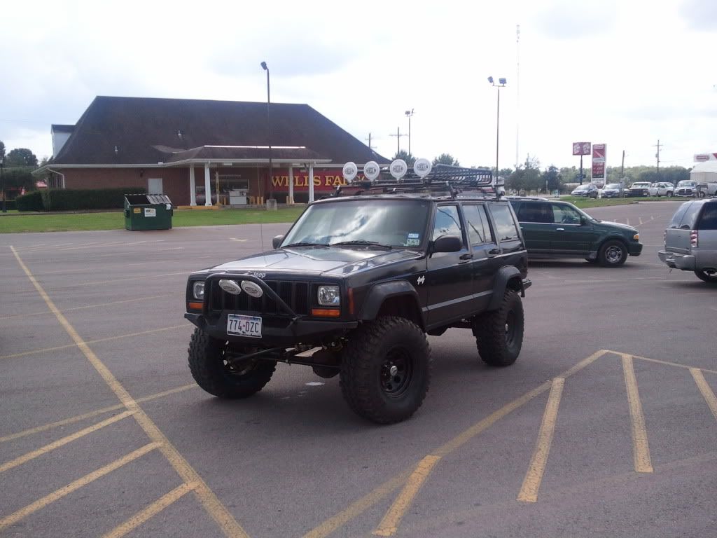

post #70 of 74 Old 09-24-2010, 11:35 AM Thread Starter
cademan04
1997 XJ Cherokee
Location: cleveland, tx
Posts: 428
just got my new mastercraft courser mt's put on, in the 33x1250x15 flavor.
