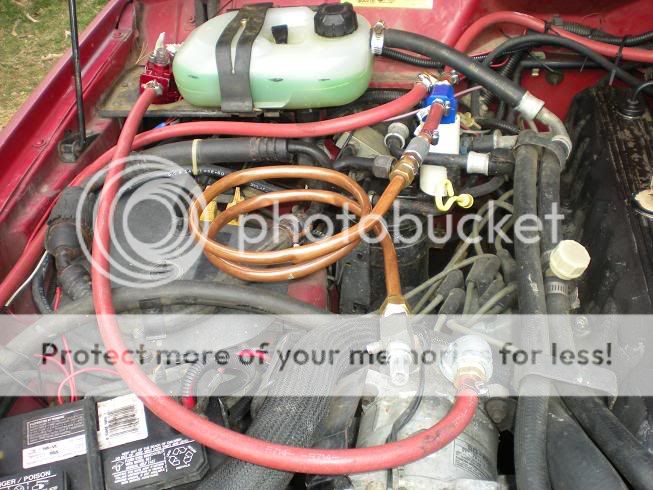

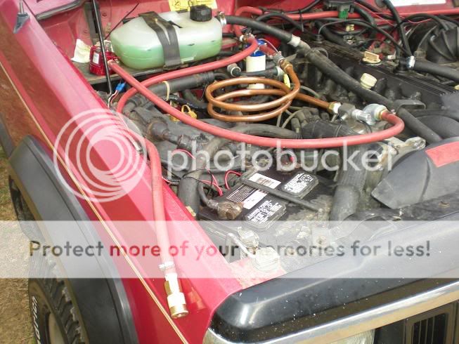

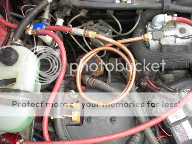

post #135 of 297 Old 03-11-2009, 04:55 PM
RitterXJ
1990 XJ Cherokee
Location: SOMD
Posts: 581
I copied your idea and here is what I came up with. I made the front output so it can stick down and be sheltered in the fender area. Rear conmes right off the tank. Total cost was about $140 but I bought from a local hardware store so prices were higher.
My tank I used an old firefighter oxygen tank
Just
Everybody
Elses
Parts
My Cherokee's very slow progress in pictures:
RitterXJ is offline
