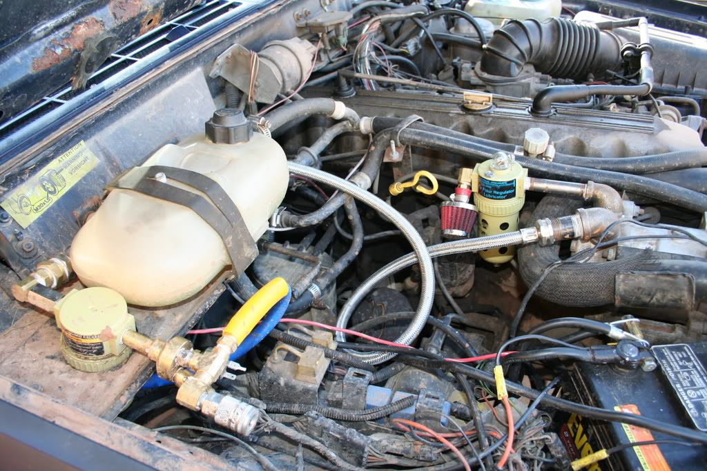

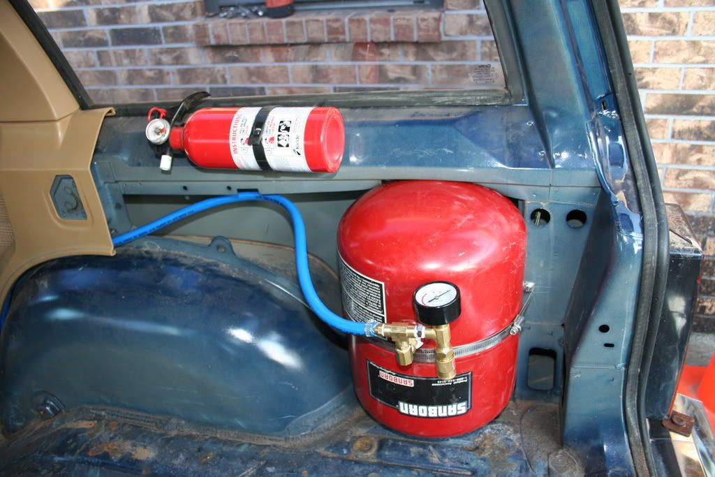

Here are a couple of pics when I finished.
