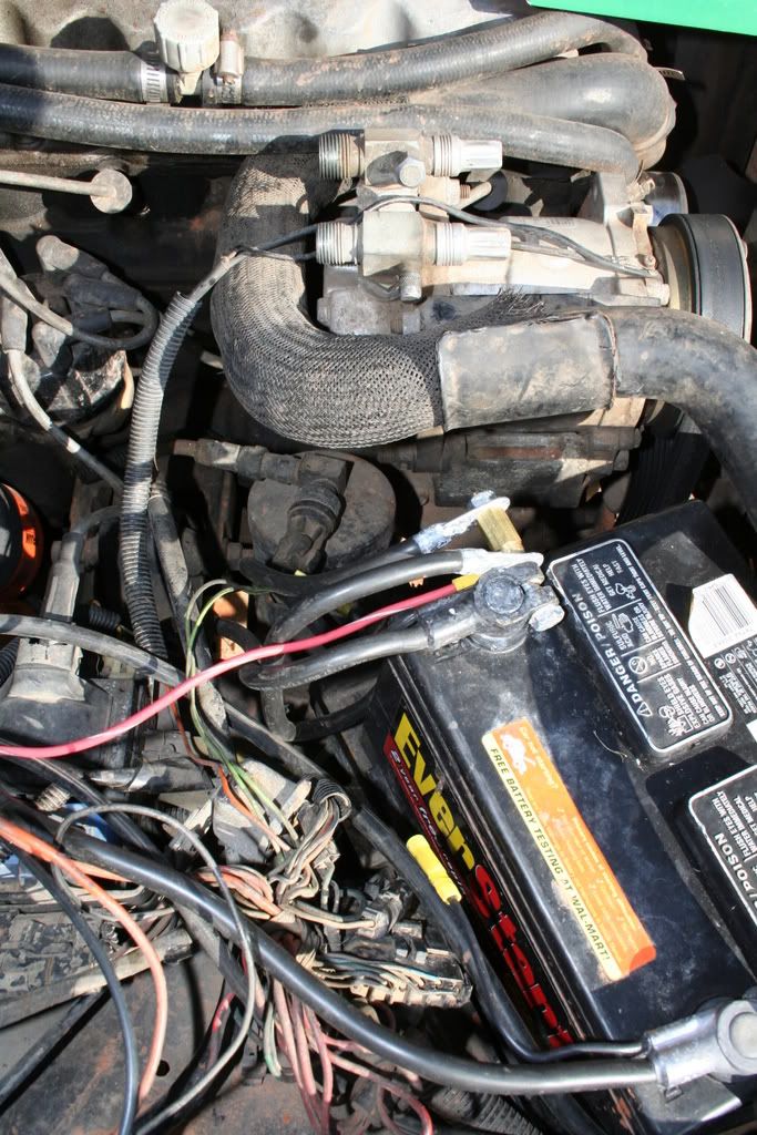

Originally Posted by cox_xj
could you PM me a pic of your engine bay as a whole?
Will this do? I could get a better one if you really want.. this was taken before i switched to the peice of copper tubing.

Posts: 481
yeah that works, its looks like if i go ahead with my battery relocation and reroute the upper radiator hose i should be able to make some sort or bracket to mount it next to the original AC one
then its a matter of re routing the belt

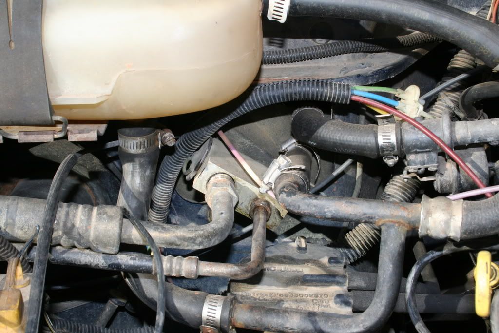

I'm outside slowing working/planning this out. I just need some clarification on a few things...
First, as I'm disconnecting the a/c lines (got it professionally evacuated), what needs to get thrown away? One line coming out of the compressor heads to this box...what is it?
Second, the other line coming out of the compressor travels to the radiator, then thru another hose ending at the black cylinder (bottom right). Can this be removed as well?
Third, there are two wires running off the Sanden, they join each other and turn into a single orange wire. It then travels to the huge wad of wires at the bottom of the pic. Can i simply cut this wire and wire my pressure switch?
Sorry for all the questions, first time for everything. And Id rather learn what all this stuff is than just removing parts and trashing them.
