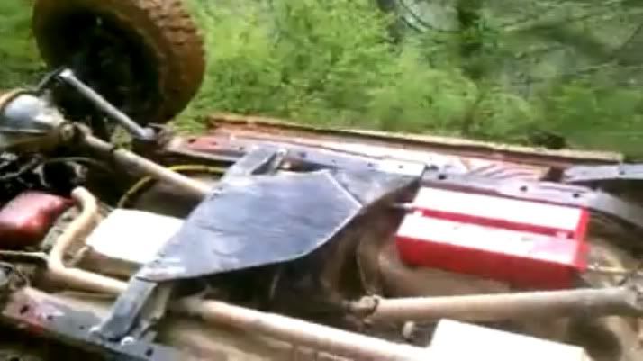

When it comes down to it, it's really not that much more expensive to get an air tank. When I did my conversion, I used med-high quality parts for the oiler and air/oil separator (de-oiler); so the added cost of a tank would have been relatively nothing. You can find them on craigslist for cheap. Look for a cheap pancake compressor and just pull the motor/pump off and use the tank.
The only problem with a tank is finding a place to put it. I wanted mine outside of the cabin, so I cheated and made my own. 2 lengths of 3/16" x 4" x 4" tube made approx 3 gallons (IIRC). I put it under the driver seat; it's plenty strong and made a great skid plate. It sits about an inch lower than the frame rail, but well above any stock style skid plate.
The problem is, it's sitting in my garage unused right now. Want it? I'm up in Portland so shipping should be too expensive.
Here's pic of the mounting location... (it's the red thing)
